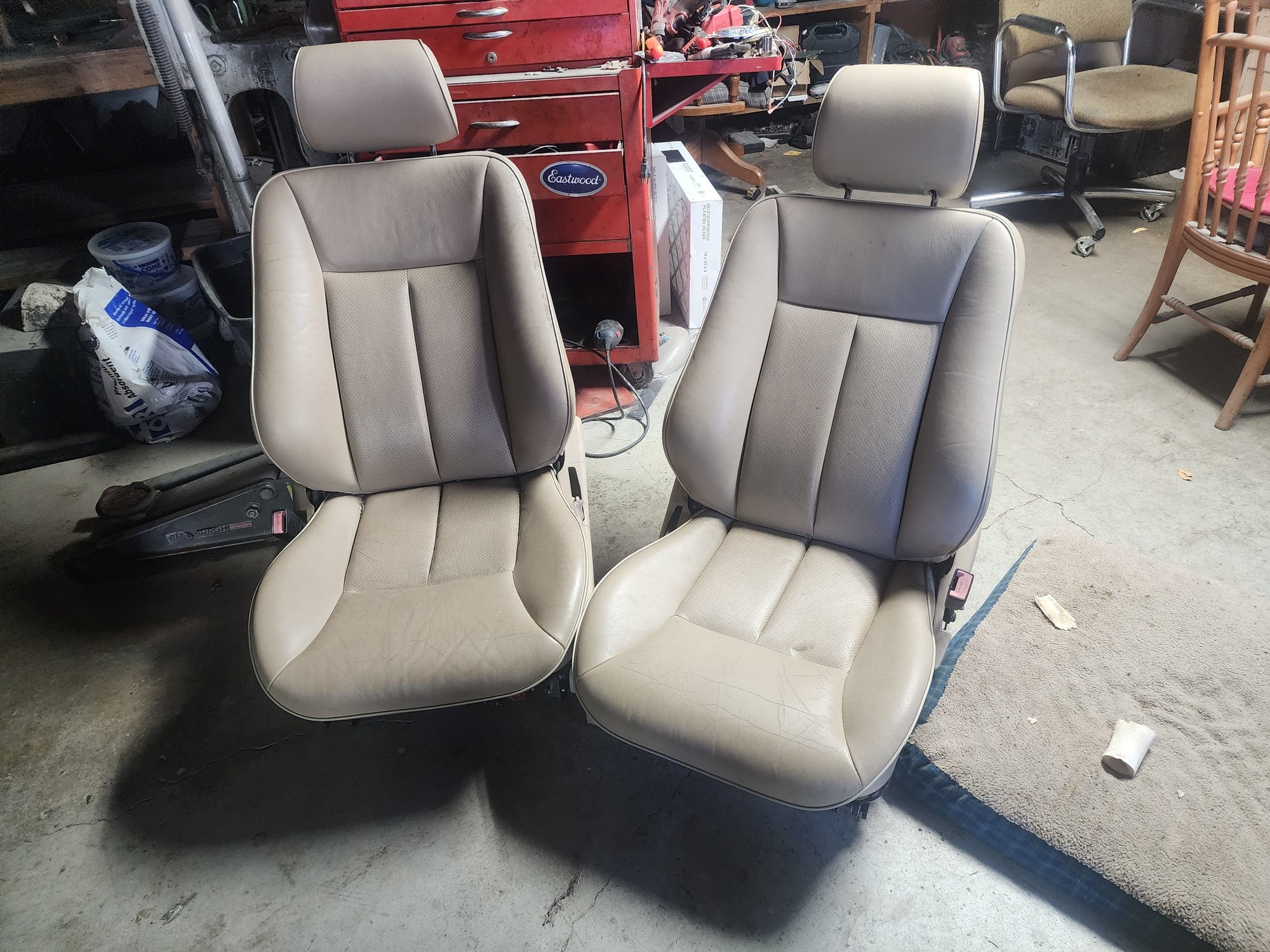

It's been awhile, but I finally found some seats. I got the pair for $50 out of a '97 Mercedes E320. I'm going to try to wire up the electronics and heaters in the seats. I'm parking the truck this winter, so I'll most likely wait until November until installing them, but at least I now have a plan.

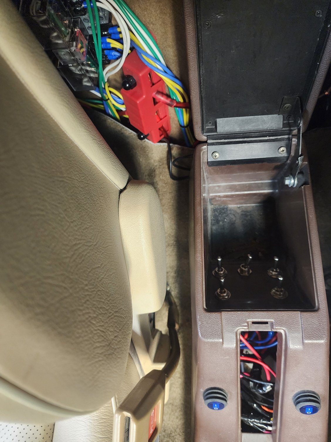

I'm finally getting ready to install these. There's a total of six motors for the two seats. I started out thinking a selector switch for left or right and a switch for each motor, but got to thinking that a I don't want that many switches. Now I'm thinking a left-right switch and with DPDT relays I can get away with a total of four switches, possibly in the console. I'd like a selector knob and one switch, but can't find a 6 position rotary switch that will work for me. I'm giving up on getting the heaters to work. There's so much wiring in these and I can't find a schematic on them anywhere. I'm also looking into some way to make my shifters look better. I can't find shifter boots, so I guess I'm going to walk through the junkyard and look for a console out of some other car I can butcher to fit my truck.

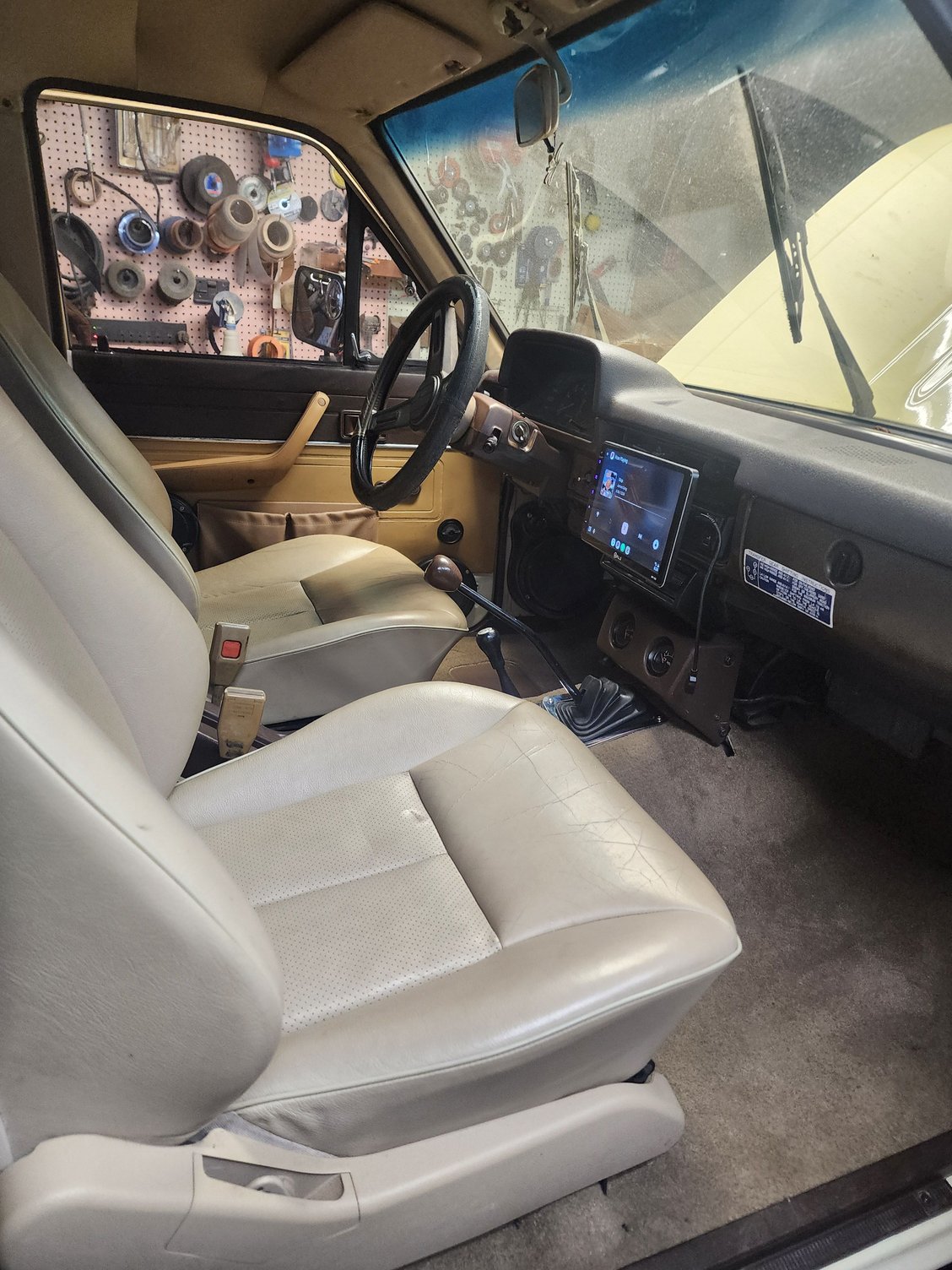

From: South Haven Michigan
I finally got the seats in the truck. With the cab being so small, there's not much room for adjustment, but they're more comfortable than stock and they're heated. I never use the small console, so I figured it was a good spot to hide the controls. The lighted blue switches outside are for the heat.

Daaamn you got switches on a first gen? The seats look good, they fit well in that cab. Is that an ipad as your info center? How did you attach it?
