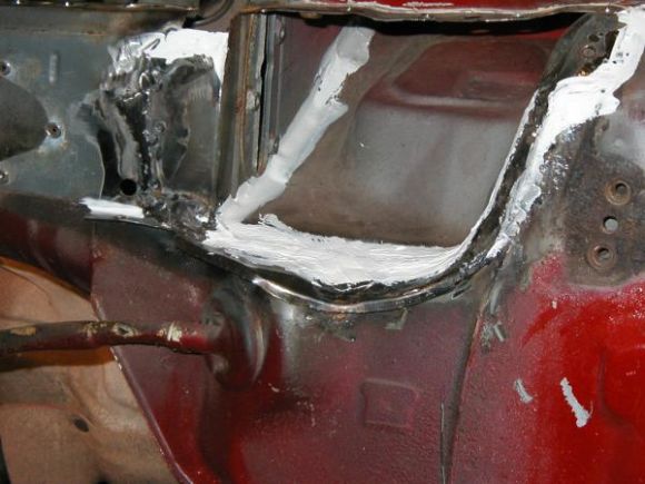

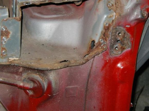

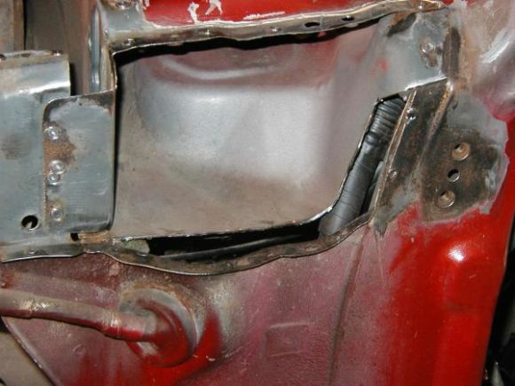

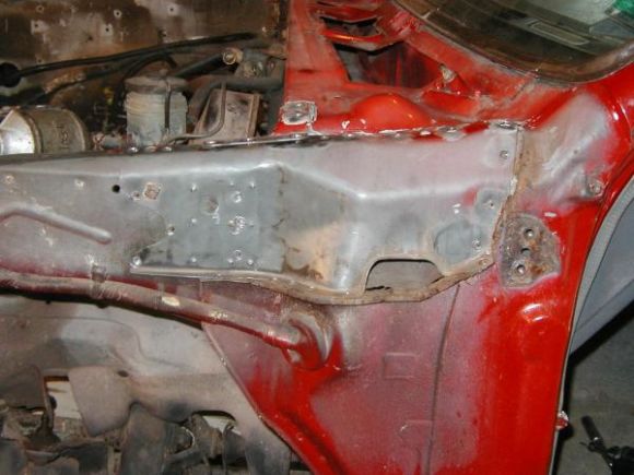

cowl repair pictures
1983 Window glass seal leak?-cowl.jpg1983 Window glass seal leak?-cowl1.jpg1983 Window glass seal leak?-cowl2.jpg1983 Window glass seal leak?-cowl3.jpg
I found this from another member who did a repair job im dreading to do....

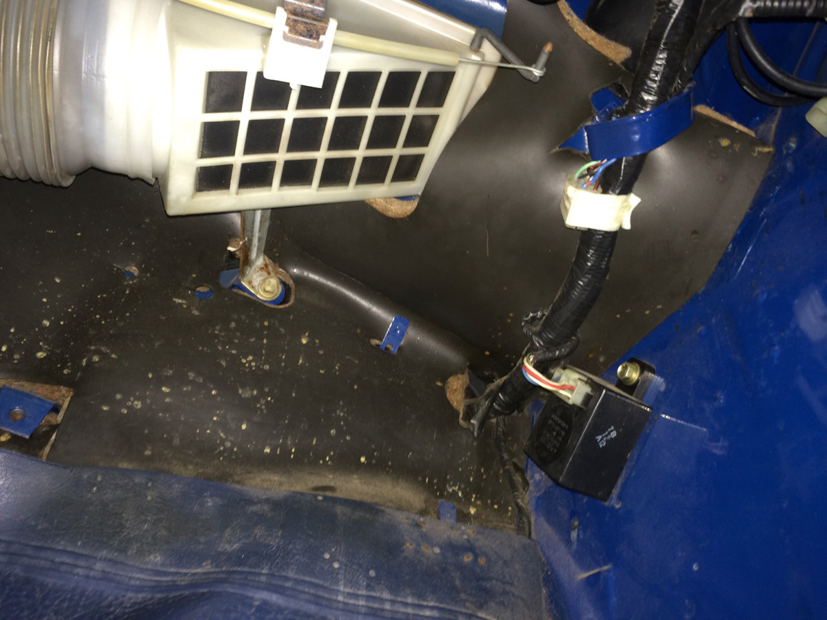

I'd remove the fender to see things from the outside. Look for dried out/peeling/missing seam sealer, as well as rust-thru. Be sure to get a good look at it from the inside, too, up under the dash. Unhook the insulation and peel it back so you get a view of the bottom of the airbox, where it attaches to the firewall and to the side. Once you get a clear view pour water over that area of the cab and then look inside for where the water's coming in.
I've attached a picture that shows the area from the inside on my '82. Can't see much with the insulation in the way, but that's the bottom of the airbox in the upper half of the image.
