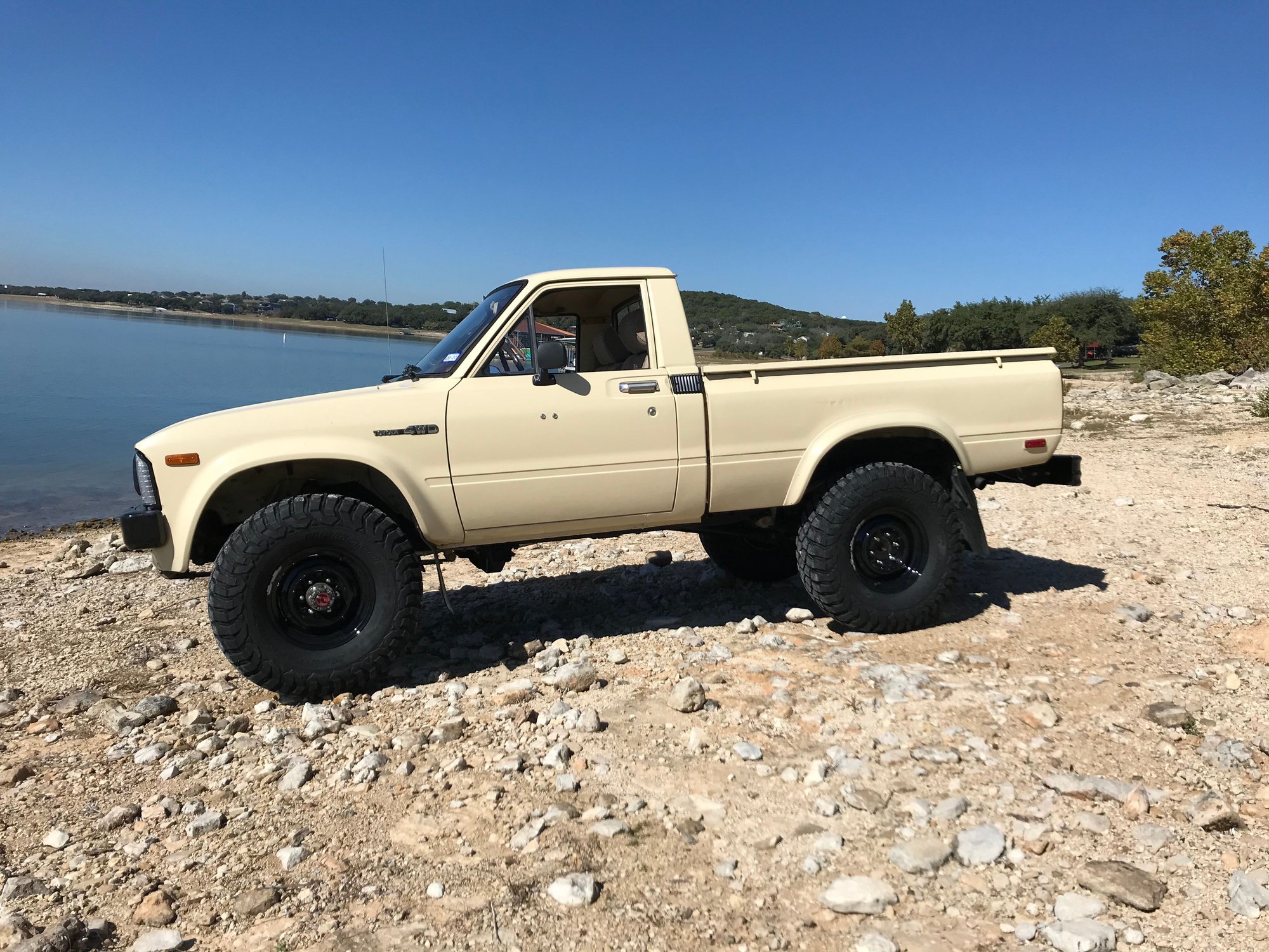

Updated pics.

Ah-ha! You painted the wheel wells black too! I always thought it was cool that I could have people look at the wheel wells and see that there was NO rust. They were always shocked to see that. But, I did think about painting under there. BTW- that rubber sheet that was in one of the boxes of parts was intended to be some new splash guards to replace the missing ones. I never found the right plugs to hold them in place though.
No sir, I didn’t paint the wheel wells. It must be the shadow from the picture. I’ll rummage around and find the rubber sheets. I think I have the correct plugs already!

Nice stance. You got any info on the bullbar you pulled?

That’s a nice truck. Why not change up to 16” rims? Lots more tire options. And why planning dual cases? That thing is too nice to turn into a crawler IMO.
Thanks!
The wheels/tires are a long story, but the short version is that I wanted to go back to OEM Toyota 15” steel wheels. I bought what I thought was remanufactured OEM Toyota wheels. It turns out they were Toyota wheels, just for an IFS truck. So they wouldn’t fit my ‘83. And at that point I had already purchased the 15” BFG tires. So the Wheel Vintiques was my solution.
In hindsight, I would have just kept the 16” wheels that were already on the truck, and upgraded the tires. But here we are.
I think a dual case has its advantages even if you’re not rock crawling. Descending steep inclines, or 4WD technical terrain at low speeds works well with a dual case. Plus, I think they’re awesome. But you are correct, the truck is way too nice to beat up on the rocks.
