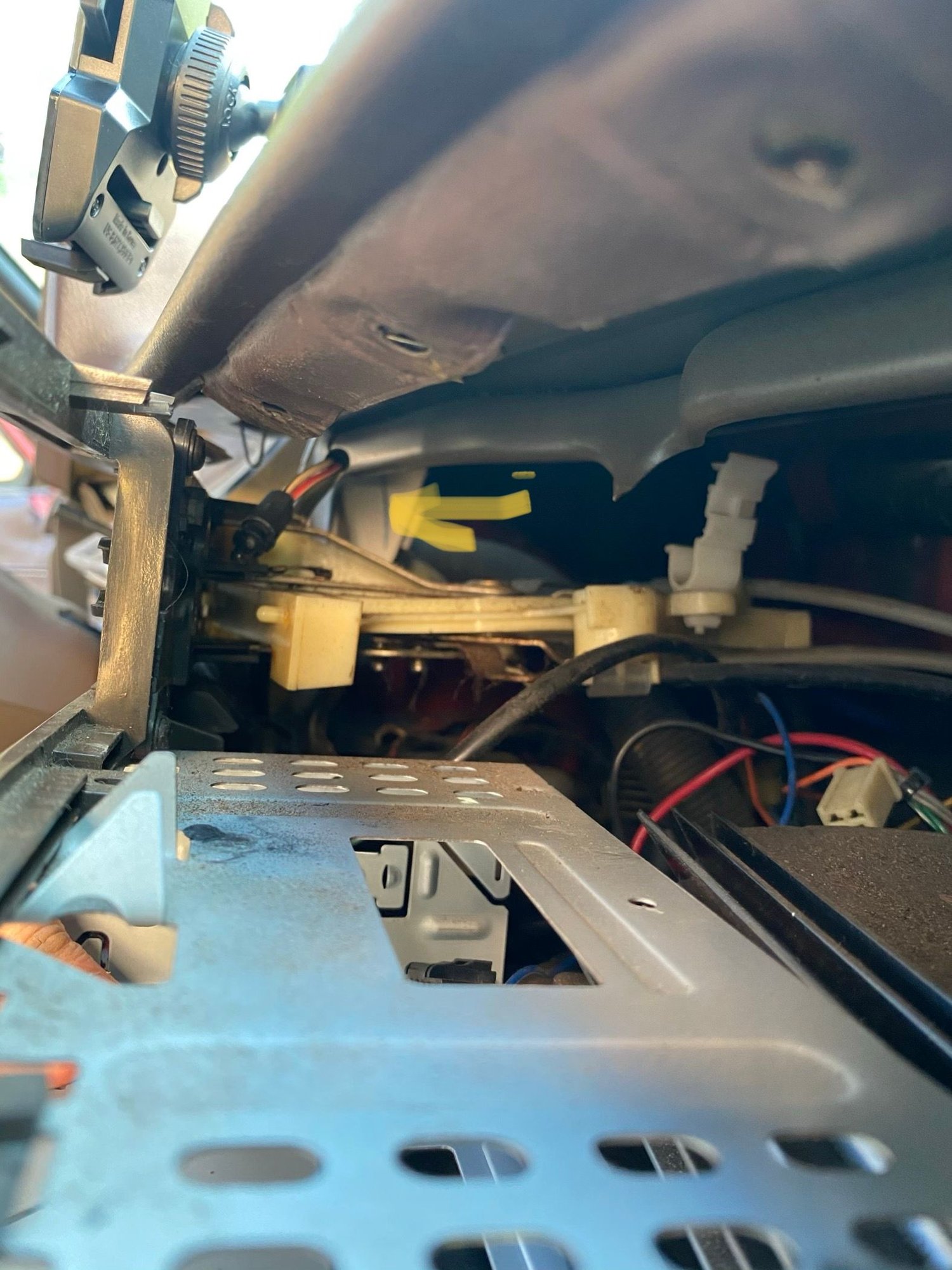

hey y’all, first time here. I am trying to remove the dash to replace the cigarette lighter on my 1983 Toyota Trekker. Just got it and I’m in heaven.
having a headache bc the climate controller inside the dash (the white plastic piece) seems to be attached to the front panel of the dash by two screws that seem impossible to access. I drew a yellow circle around them.
based on the note above, if I unhook the cables, will the entire climate controller white piece come out with the front of the dash? If so, how will I get those cables reconnected if I pull them out?
thanks,
sam
I drew a yellow circle around where it appears there is a screw keeping the white plastic climate controller attached to the front panel of the dash.

really easy to hook the cables up again , they just snake in the way you pulled them out .. they just connect on to the heater door flaps via a "circle and a tab" you just need to release the cable holders near the ends where they connect .
