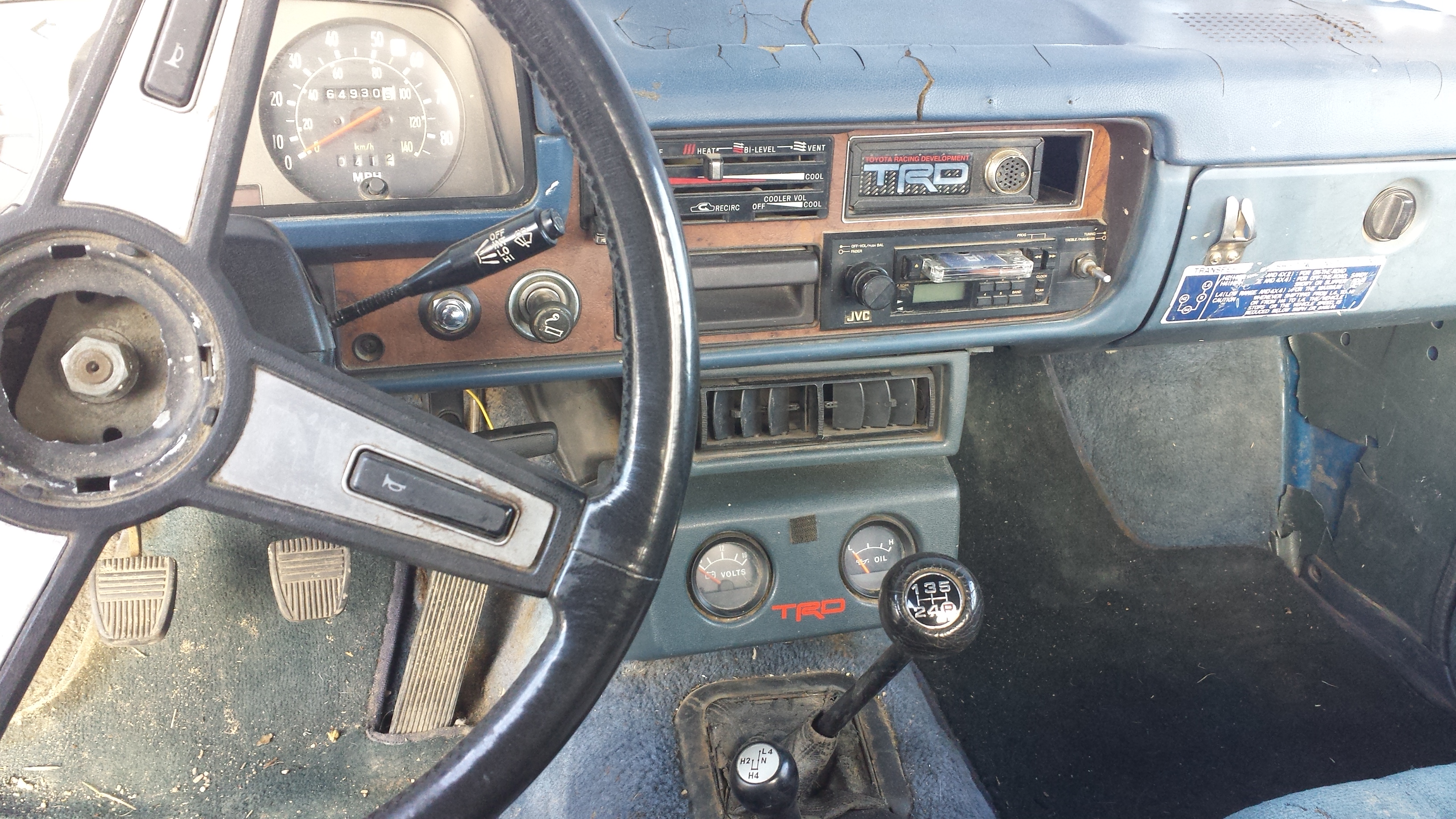

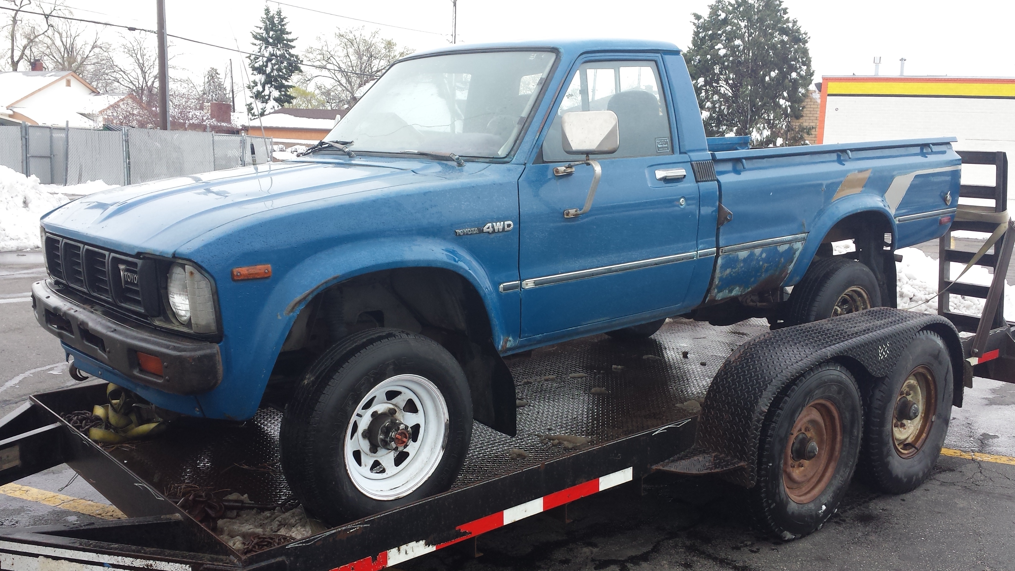

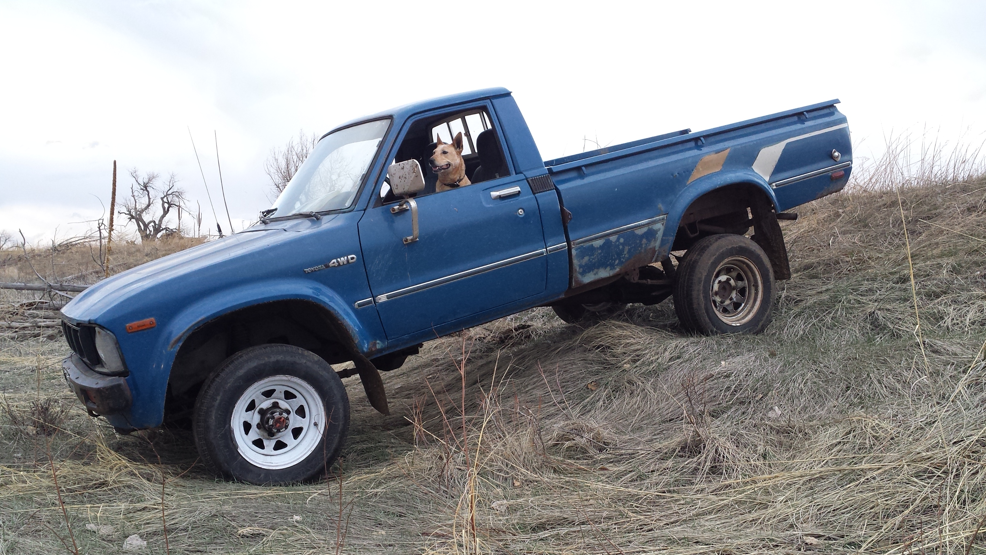

Picked up a 1981 Toyota 4x4 with 64k on her. There are a few dings and scrapes but overall in pretty decent shape. I was going over a few things and noticed the drivers side wiper did not work. Come to find out the linkage is disconnected from the passenger side. Passenger side works fine. My question is how do you access the linkage? I have the Chilton manual for it but it says to remove cowl. It seems to be a solid piece from the firewall up to the windshield. Any thoughts on how to reconnect the linkage??

Thanks Lon81 for your response, I took it over to a buddies today and we got it just like you explained but took both of us finagling the linkage to get it snapped back in. The problem soon after we finished was the wiper ended up over extending over the A pillar. If you look at the first pic you can see where it has been rubbing for awhile and has been rusting too. Buddy is gonna grab some new linkage from Yota Jims and see if that will work.
