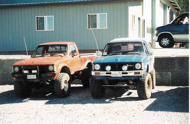

'81s came with 3.90 gears, 33s will work but performance will suffer greatly until it's geared properly. the orange trucks been on 33s forever and never had any problems
