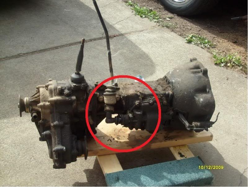

non running condition project, $500 would be the top most would pay for it.
if it has the side shift L-43 4 speed transmission you will want to swap in a 5 speed (L-50/52) or a top shift L-45 4 speed, the side shifters are very sloppy

-that truck has the typical toyota rust at the seams of the bed, finding another bed for a 79-83 is getting very hard
-79-83's floors tend to rust out at the 4 corners of the cab in the floor, be sure to pull up the carpet or vinyl to check
-finding parts for 79-83's are getting harder and harder to find
NADA or KBB has no real world bearing when setting value for older toyota trucks, it is all what a buyer is willing to pay and what the local market will bear

Thxs for the info dropzone. I will have to see what transmission it has.

My 1980 started out looking a lot like this one. I took my time and did things as I saved up the money. Being a mechanic, I did all the work except paint and interior. I have the L-43 trans and it did have slop in the shifter. Turns out the bushings between the shifter assembly and the body of the trans were completely missing. After replacing those, it shifts great. I dug out the sealant between the bed sides and floor which causes that infamous rust and welded all the rust holes up had a friend of mine do the paint. I would definitely pour marvel mystery oil or better yet, a 50/50 mix of acetone and ATF into the cylinders and let it sit for a while before trying to turn it over. Use a breaker bar and turn it over slowly before trying the starter. Change all the fluids: engine, trans, diffs, transfer case , brakes. A little bit of money and a lot of work will result in a good truck. Check out the pictures of mine in my gallery.
