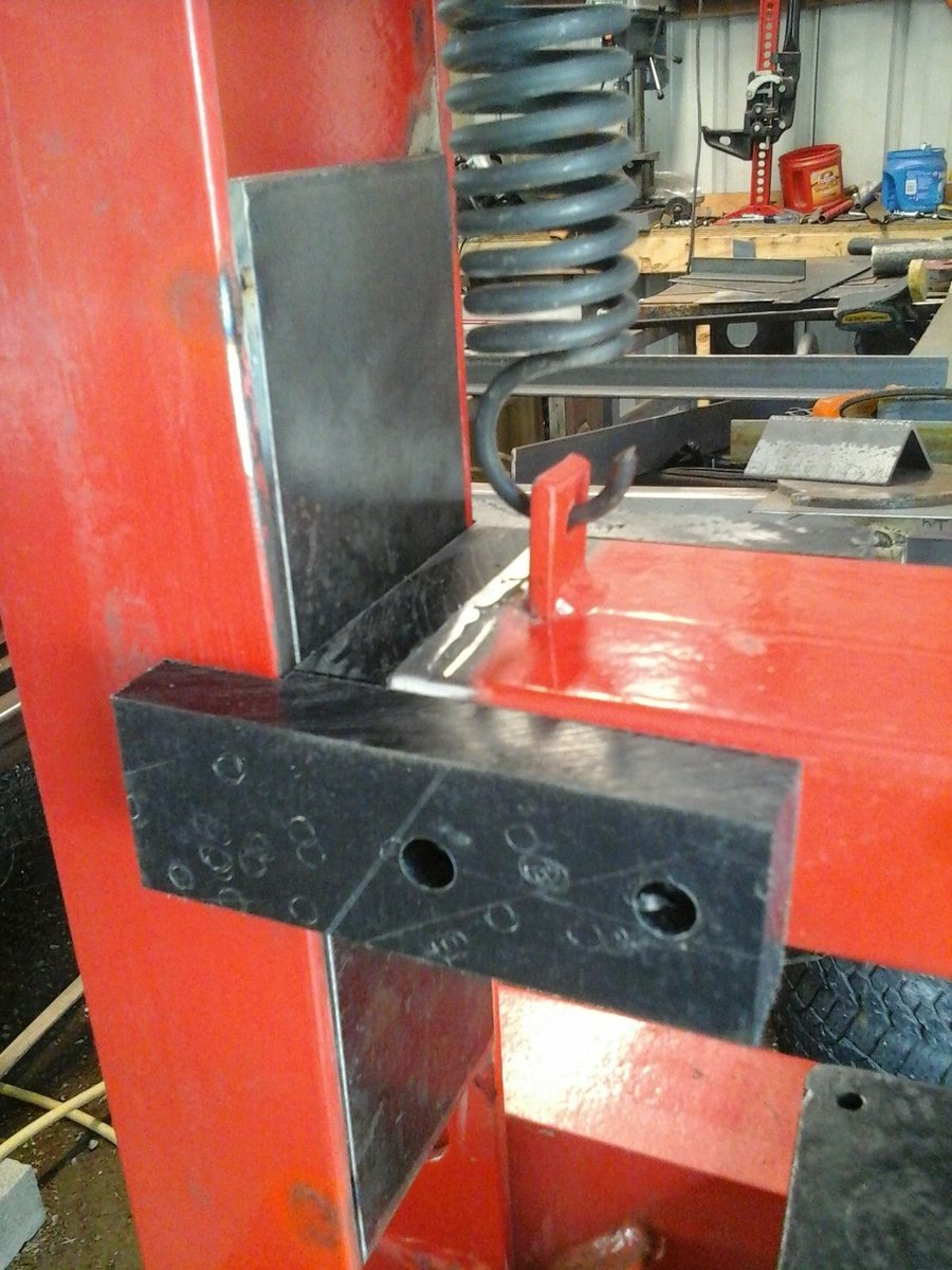

After getting the press home and looking it over more closely I noticed that the press had alot of back & forth and side to side play. So I decided to make some better guides to tighten it up a bit. I ended up making some new guides out of some scrap peices of UHMW that I had. Before starting it had over a 1/4" of play front to back and side to side, now it has maybe a 1/32" side to side and none front to back, alot better now! Here's some pics.
^^^I cut the ends off the structure that the jack bolts to so that I could attach the uhmw guides
^^^welded a 1/4" thick steel plate inbetween the main frame stand so the new uhmw guides had a flat surface to ride against
^^^ also made this little "T" handle to make it easier to release the pressure without having to use the jack handle.

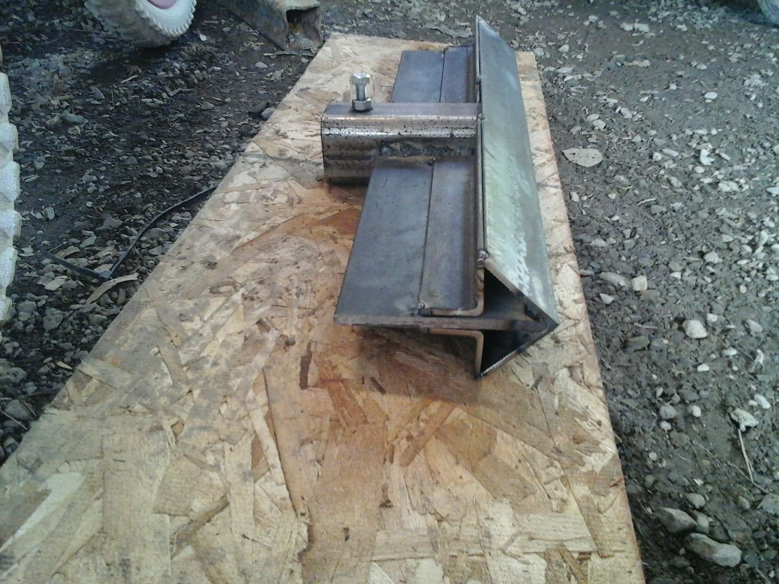

DIY 90° press brake
Here's a press brake I started building today, Its all just scrap metal I had laying around. Should be able to bend a 90° bend in a peice of sheetmetal up to 17-1/2" wide. need to finish welding it up and paint it. I'm going to build another one with a round pipe for the die so I can make curved bends too.
^^^heres a scrap peice of 16 gauge I made a couple practice bends with, works pretty good.

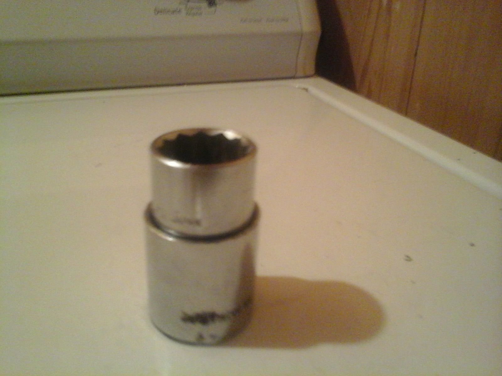

I had an idea for a quick and easy dimple die. Looked through my old sockets and found a 15/16" with a nice taper to it. Then I found a 1-1/8" socket that had a nice beveled edge on the inside, so the two sockets fit together pretty nicely. You could probably substitute a piece of pipe that's the right diameter, or maybe use a grinder to bevel or taper an old socket if you can'take find two that fit together very well.
◆EDIT◆ I went back and welded a bolt that goes up through the 1-1/8" socket, this helps keep it aligned and centered with the hole better.

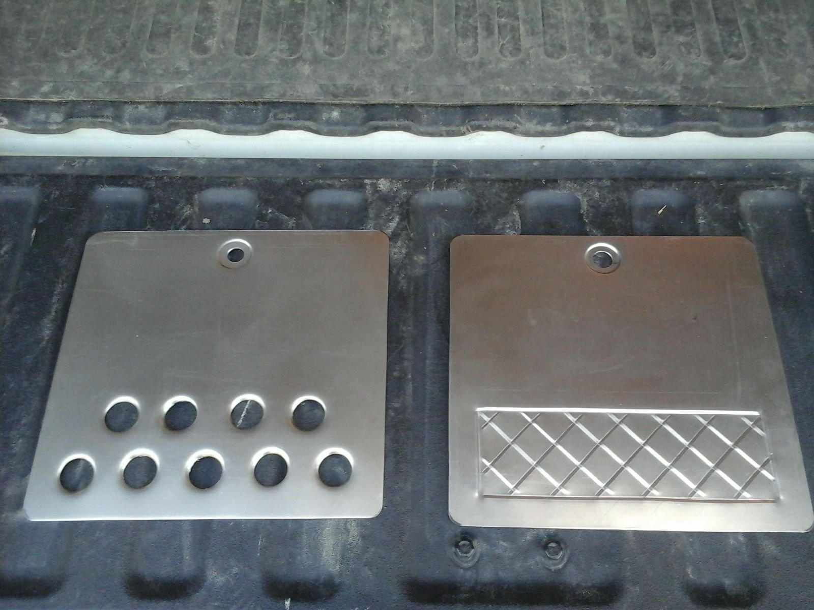

DIY flat recessed dimple die
I took a peice of 1-5/8" OD tubing and welded it to a peice of flat plate. The plate had a hole drilled in the center with a nut welded to the backside. Then I threaded a bolt up through the center to keep everything centered when I put it in the hydraulic press.
I stacked 3 or 4 flat washers inside the tubing to get the desired depth.
I used a 1" socket to compress the sheetmetal.
