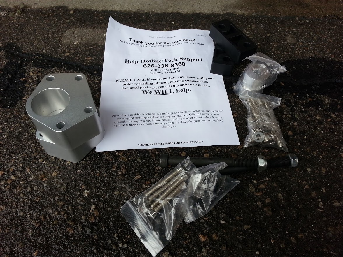

this kit includes Ball joint spacers and front differential drop kit too. so that its complete lift kit. although you need to modify upper control arm in order to install the kit. i think you might needs to install extended front shocks. this is also good opportunity to replace

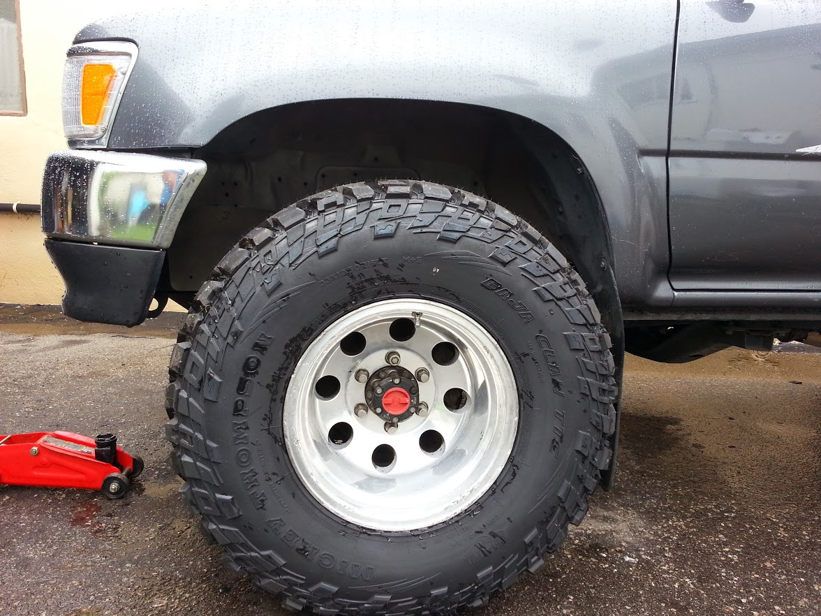

i'm trying to put
Mickey Thompson Baja MTZ Radial Tire - 33X12.50R15LT 108Q in stock truck, i have install them but its rubbing the fender when i make the turns.
This is the Lift Kit and all the parts

Nice write up. Did the spacers alone solve the rubbing or did you have to crank the torsion bars too or install an additional lift?
15x10 rims?
