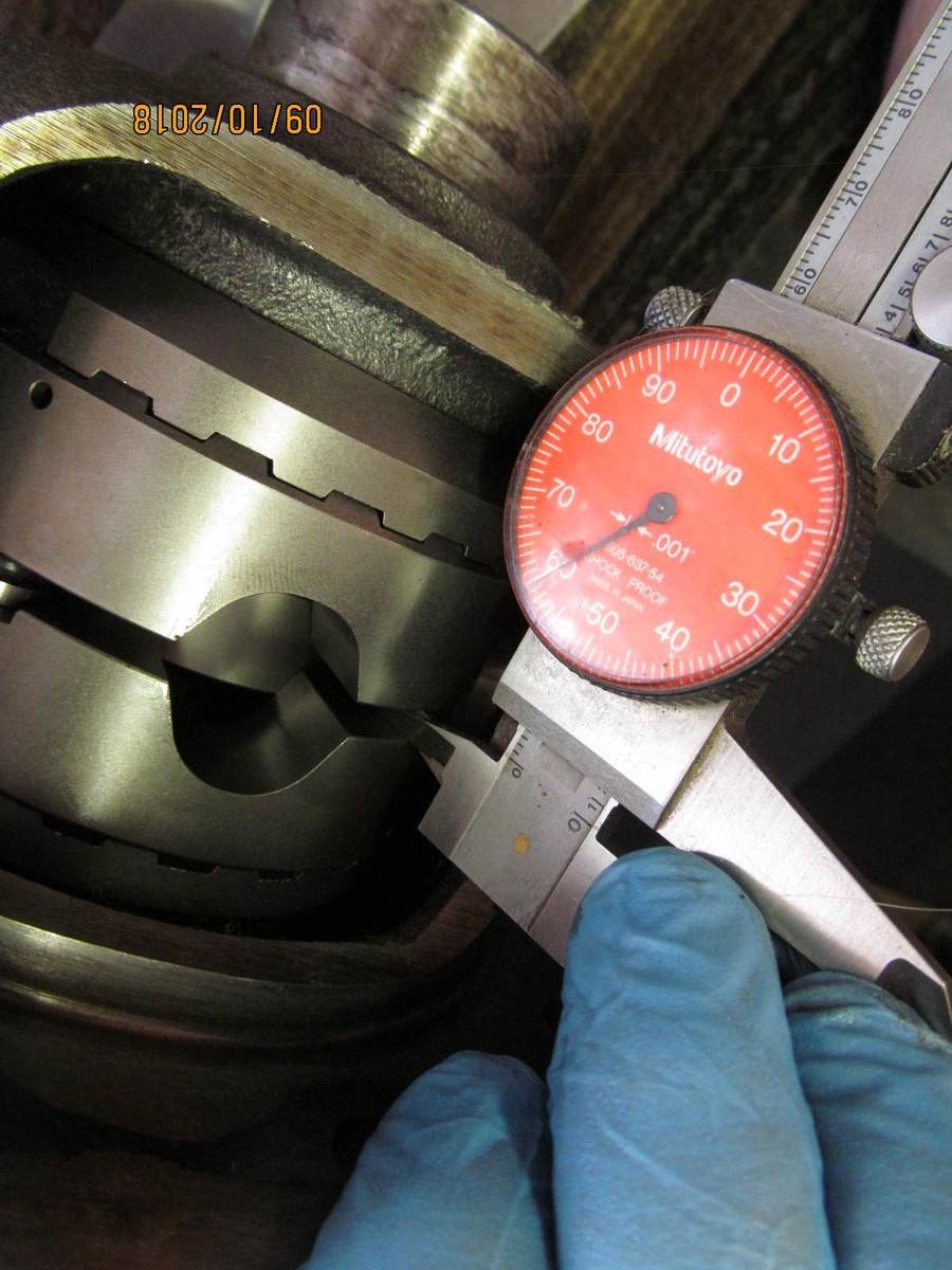

I've had this Spartan in my rebuilt front 3rd for close to 6 months now. I had Zuk install it & rebuild my 3rd while I rebuilt the remainder of the front diff & replaced all steering components so everything from inner tire to inner tire was replaced except ring & pinion.
I had wheeled this truck lightly in mud & general trail rides & it did ok but not great. The tires are really to wide ( 31x13.50-15's super swampers ) so it floated a lot on loose gravel & debris without weight in the bed. I had always wanted a locker front & rear so I ordered 2 Spartans off ebay @ $252.00 each after talking to a million guys & getting the opinion of Zuk. 1 for each diff & he installed the front first. I wanted a selectable locker but couldn't afford them and this seemed my best route
I had a certain hill my truck had difficulty going up before on a local trail & went out to try it with the new spartan up front . This time it just crawled right up it no spinning & zero problems. This pickup doesn't have power steering & turning while locked requires both hands ( and arms ) if at low speeds & that does suck alot in tight spaces
I hear people talking about the sounds when locked & turning corners where it unloads but I can't hear mine probably because other noises drown it out but it's super quiet. I don't drive with my front engaged on dry pavement either so maybe that's why. It locks quick & Zuk said it was the strongest rachet/automatic type locker of the field.
After living with it I decided not to install the 2nd Spartan in the rear because I think I'll save up and buy a selectable locker for it since I drive this truck daily & sometimes on icy roads where a Spartan really isn't perfect, maybe I'd get use to it but lifes short & I think an arb or E locker would be better for my style of driving mixed with road time. The 2nd one is at Zuks shop in Chandler Arizona waiting on someone to need it so I can recoup some of my $ on it & it can be put to work
All in all it does it's job effectively & quietly & the added traction really is awesome and the places I can go now without having to rip on the truck are much more open. I regret not going to 4.88's or 5.29's while the 3rd was out but you live and learn.
So that's my little short review of the Spartan.
