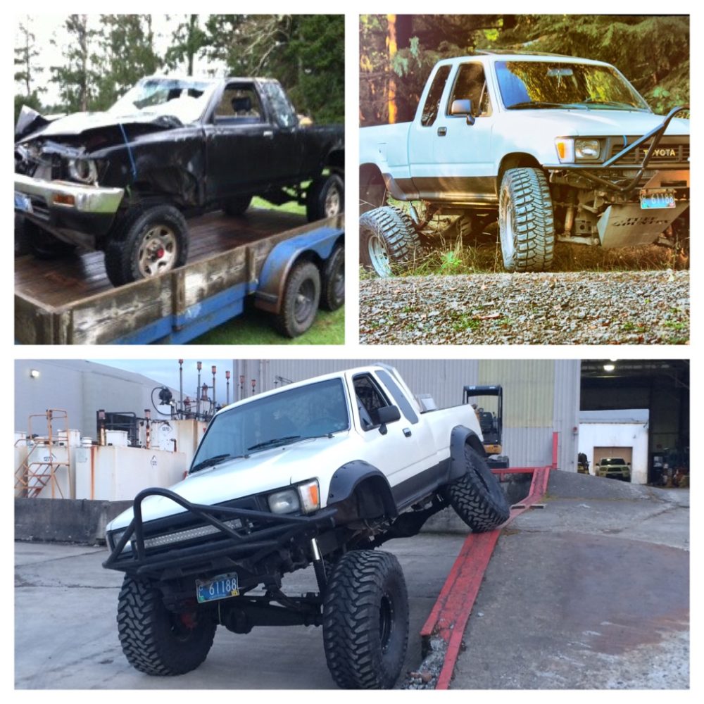

“I got an ’89 Toyota pickup a few years back. I figured it’s time to start a build thread on it because I realized I’m never getting rid of this truck and there’s so many things that I have planned.

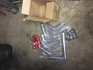

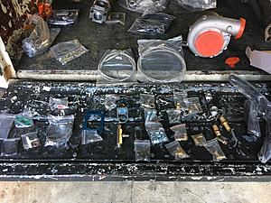

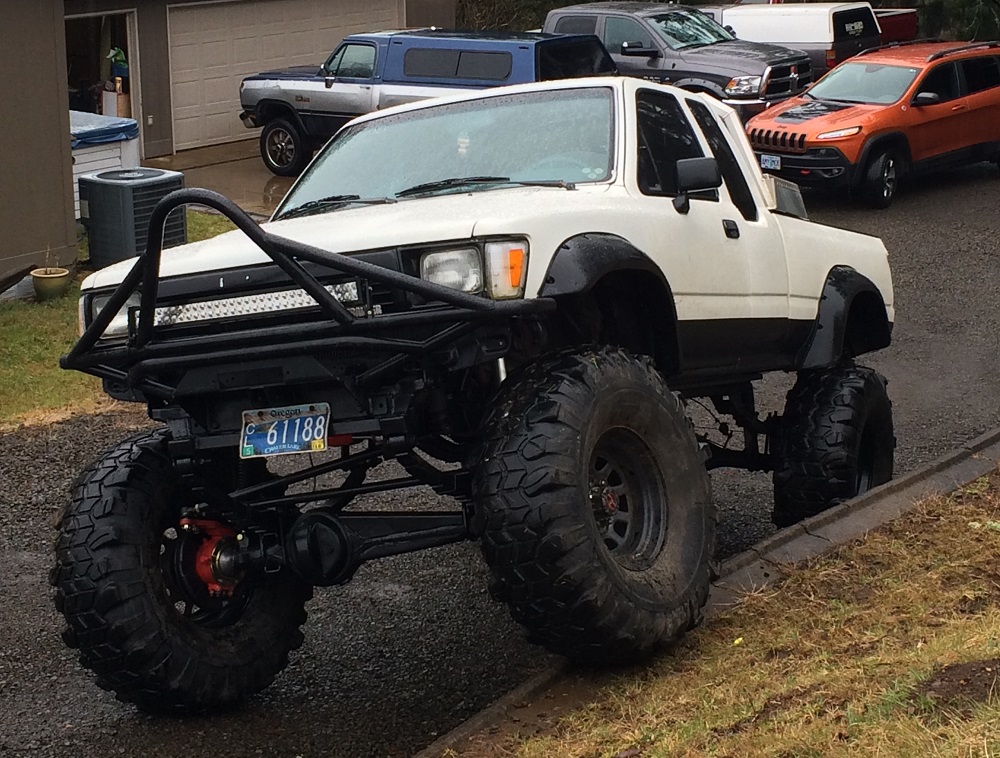

Just to bring everyone up to speed, I got the truck totaled. After that, I bought all new body parts, replaced the body, then did all the bodywork and painted it. Next, I cut all the stock suspension off the vehicle and put 63s in the rear. Then I used the Trail Gear 4″ SAS kit. The next big upgrade was the 2JZGE out of an ’01 IS300. The next plan is to turbo the 2JZ and I plan to document that whole process on here as I go through the steps.”

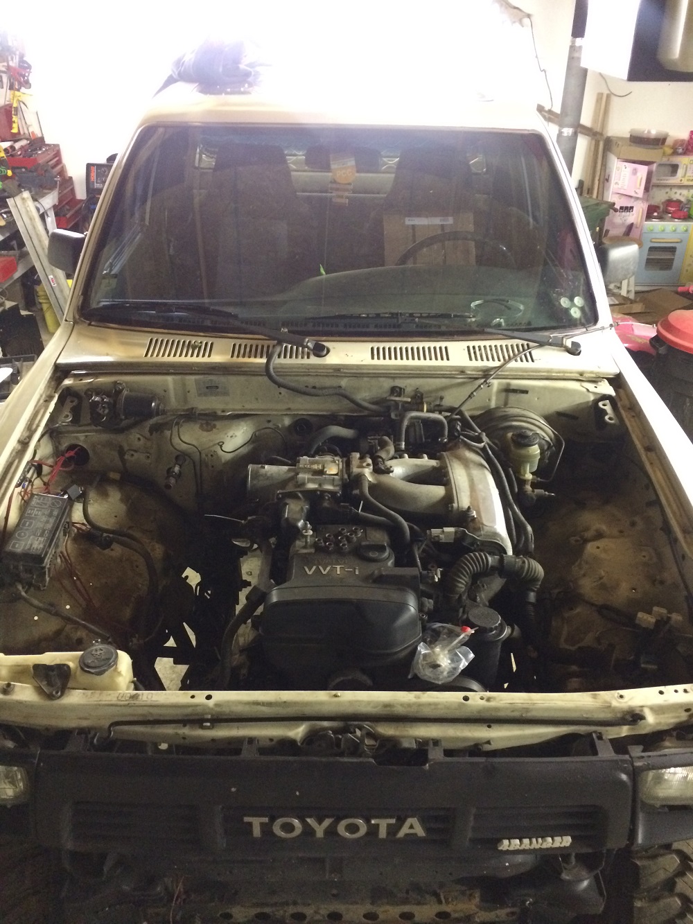

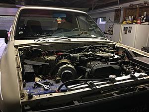

“Finally got around to changing the timing belt and water pump on the 2JZ engine. The engine is so tight in there that I had to pull the radiator and cut the crossmember in order to get at the engine. After all that was out I pulled the crankshaft pulley bolt out.
This was literally the tightest bolt I’ve ever had. Bump starting the engine was not cutting it, and neither was my air impact. I ended up having to wrap the serpentine belt around itself to keep the engine from spinning and use an extremely long pipe. After breaking two breaker bars I finally got it loose.”
On went a new fuel pump, fuel pressure regulator, and GTE ECU. And while we await the turbo installation, we get some more details on the swap
“I’m using CX Racing motor mounts so it puts the engine in the perfect location. It is a tight fit but everything fits, just barely. I completely swapped the Lexus harness and ignition system into my truck because there was no way around the immobilizer. I might change it back to the Toyota key when I swap the GTE ECU in, but I’m not sure yet.
Also, I’m using an R150 transmission. It was behind a 3.0, so it’s the shorter input Shaffer version. Then I got a custom bell housing off eBay for running the short shaft R150 behind a JZ engine. I got a stock IS300 flywheel and clutch kit and it all works really well together. Not sure how much power the IS300 clutch will hold, but I guess we’ll see.”
