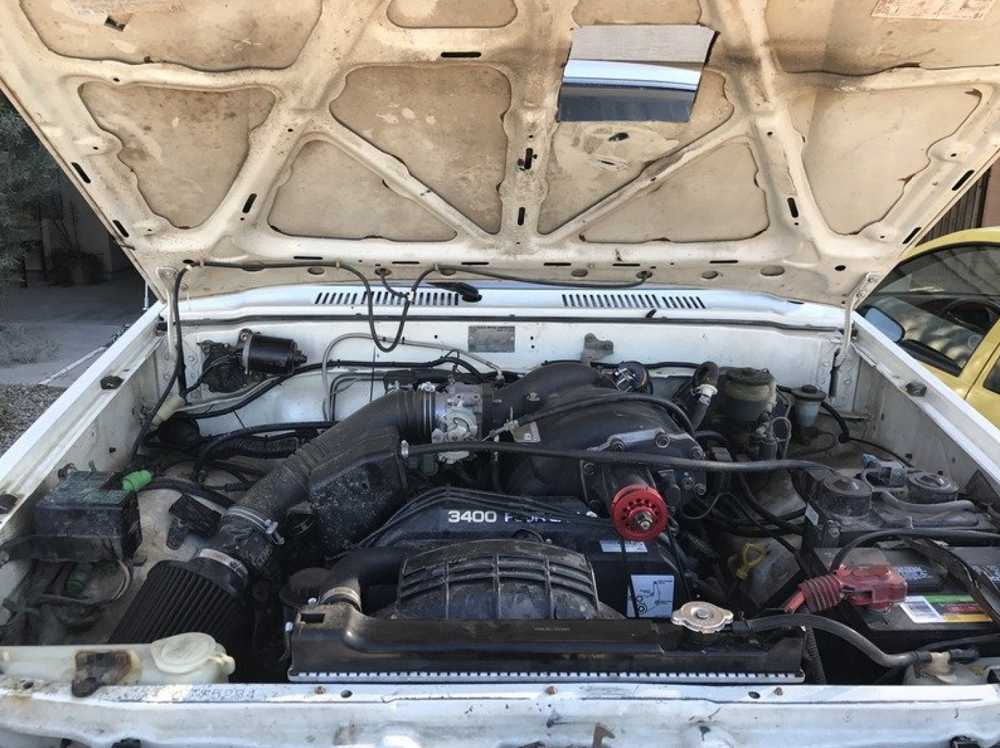

With cash and dreams in hand, the OP soon found himself buying and installing a vast array of aftermarket parts. That included a 4″ ProComp lift and 35″ tires at first. But then came the biggie – a 3.4 5VZ-FE and R150 swap courtesy of Toy Only Swaps. But even that didn’t give the OP the power he was after, so he soon installed a Magnuson supercharger. And he didn’t stop there!
“Since I go up to Northern Arizona to camp and backpack, I had bad pinging going up in elevation. To eliminate that, I installed the 7th injector from URD as well as their 2.2″ supercharger pulley for even more power. I also installed an ARB winch bumper and a Warn M8000 winch.”
1985 Toyota Pickup
And of course, that wasn’t the end of this Toyota build by any means. A custom radiator and a hood with a scoop were sourced to keep the blown engine cool. And a million other little things that have only made this old Toyota pickup even more capable and reliable on every sort of road. So be sure and head over here to check out the build in its entirety!
