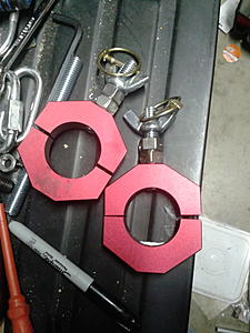

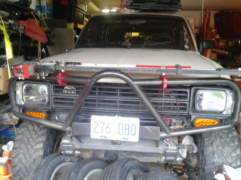

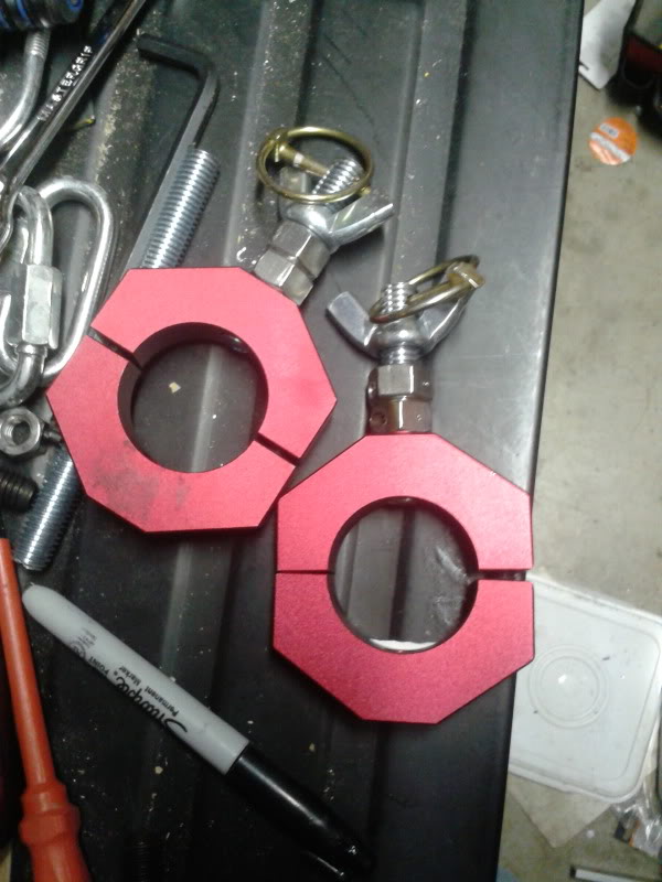

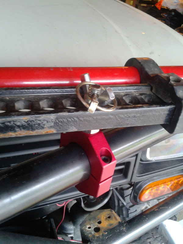

Few small things since the last time that I posted. I decided to mount my Harbor Frieght hi-lift jack to my front bumper. I bought a set of Four-Treks 1 7/8" Modular Hi-Lift mounts. They seem to work very well. I am still undecided if I want to keep them. Not because of the quality or anything like that. They are very well made. I just don't know if I am happy with my bumper up front or not. It might be moved in the future when I get a custom luggage rack made to go around my truck cap. My buddy also started making stickers so he made me a few with my Instagram handle. Maybe it will get me a few followers ha ha.

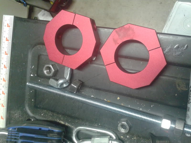

i have always like the ARB bumper on a 2nd gen Xtra Cab
I had thought about the four treks moutn on my old truck but the price was a bit much. I was search for a fire extinguisher mount when i discovered I hthese things, 4 for $40 delivered-ballast clamps for racing
For about $30 I had a set of high lift mounts:

I agree that they are a little pricey. But I heard nothing but good things about them. Decided to treat myself. Only thing I had to do was add a lock washer to it so it didnt rattle off during bumpy rides. Your's look nice too!
