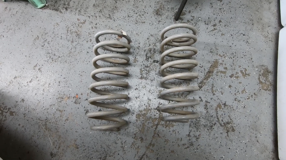

Slee Offroad Springs
So replacing those scrawny OME 860 rear springs is a must. Chowcares elects to go with a set of Slee Off-Road springs. The Slee’s aren’t taller, but they are beefier with a higher spring rate.
Lastly, Chowcares warns to be careful how you install the springs noting that the L and R springs have slightly different lengths and must be installed on their proper side.

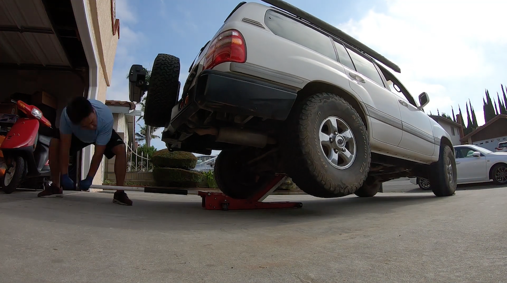

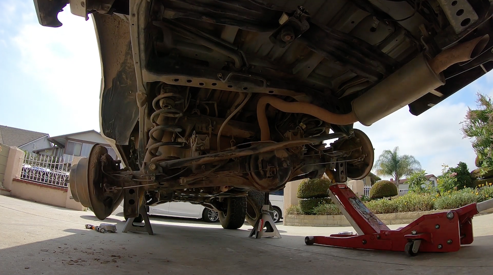

Before getting started, be sure to chock your wheels and loosen your rear lug nuts.  Next, you’ll want to jack up the rear end of your Cruiser by the rear differential. Place your non-Harbor Freight jack stands in their appropriate locations and you’re ready to drop the jack and get to the good stuff.
Land Cruiser Rear Springs Install

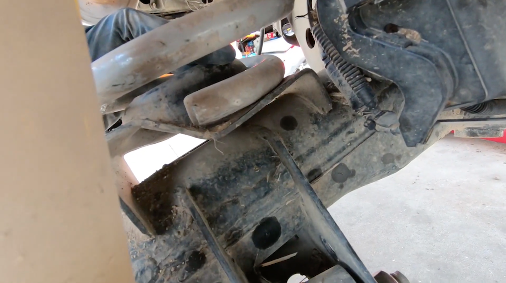

Remove your wheels and use your jack to raise one side of the axle. Place your jack just behind the caliper and lift to compress one side, decompressing the opposite spring
Now, you can easily remove your old spring and replace it with your new one. Simply repeat the process on the other side and you’ve got new springs! Easy peasy.

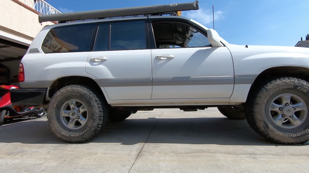

“If you have a saggy bumper or saggy rear end,” says Chowcares “Make sure you get heavy-duty springs.”
Land Cruiser 100
“Swapping out the rear springs is a complete walk in the park. Just a word of advice, after installing the Slee springs, I took it out for a test run and I noticed that it still was sagging a little bit,” mentions Chowcares “So since then, I’ve already replaced the springs again with the Old Man Emu 863s which [are] the same spring rate as the Slees I believe. However, they’re about an inch higher.”
