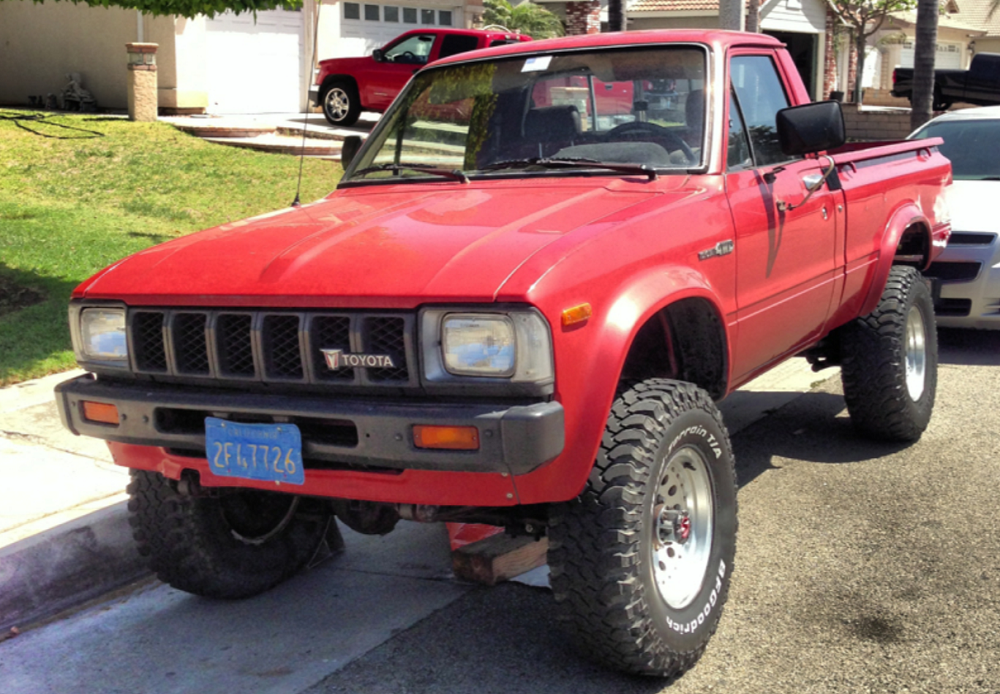

“I just bought a 1983 SR5 4×4 pickup and plan on fully restoring it. There isn’t too much missing, I just wanna make it look just like my dads since he had a brand new ’83. I am rebuilding the motor right now and will put up some pictures soon.”
1983 Toyota Pickup
The OP looks to have scored a seriously clean truck to start with, but it did come with at least one big issue.
“Got it down to $3,200. The guy said it had a blown head gasket, so he gave me a brand new head with it and a bunch of other new parts. I took the head off and it wasn’t the head gasket. The timing cover had a crack on it, so it was getting water in the motor from there. Since I already had the head and carb off, I decided to rebuild the motor. I didn’t want to put a new head on a worn motor.”

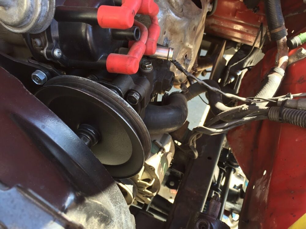

Before you knew it, the engine was out, rebuilt, and back in the truck. The OP then gave the pickup a good wax, which really made a huge difference. It was good enough that we didn’t receive another update for a full five years. Then, this project restarted with earnest as the OP worked to convert his Toyota to power steering.
