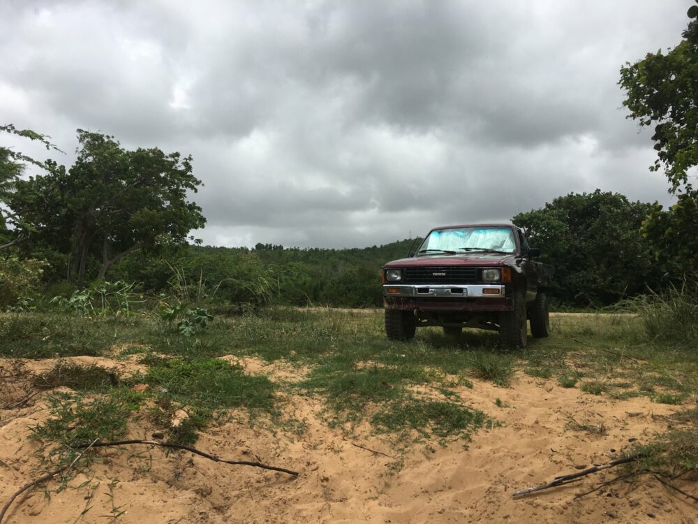

“I’m a long time lurker and first time Toyota owner. Really dig the pool of good information here. No clue how far down the owner list I am, but I got my first Toyota, a 1987 22R 4×4. I’ll post a few sweet pics of the beginning, then fast forward to now. Currently, I’m rebuilding a 22R block/head from a first-gen 4Runner I snagged for $150.”
1987 22R Pickup
The cool pickup from way south certainly looks to be in pretty good condition, but it isn’t without its flaws.
“Upon buying this truck, I quickly found that it needed lots of work. It didn’t have an air cover/filter, tail/brake lights not functional. The headlights and various other electrical pieces suffered from bad grounds and hot-wiring. There was a previous collision and a hack job rear box to haul horses. The suspension/brake systems were very abused, and it had a very dirty interior.”

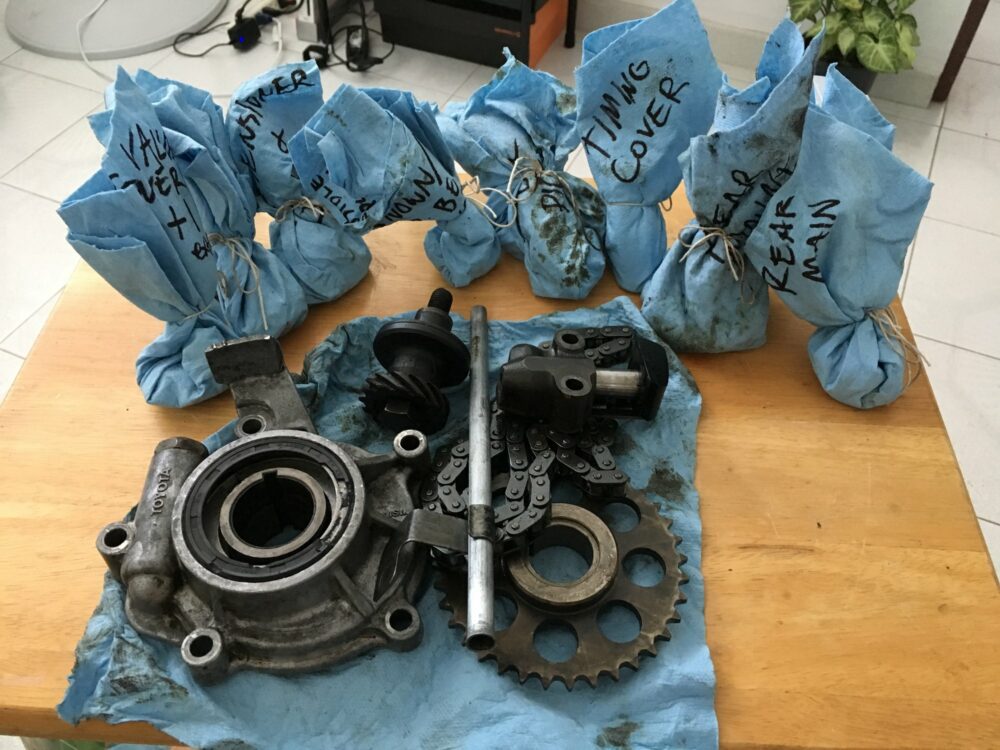

With the Toyota pickup running and driving well now, the OP could turn his attention to rebuilding his spare engine. After disassembly, he took it to the machine shop and started cleaning up all the little bits and pieces.
“Took some time to sort out all the bolts and nuts and clean all the crud off of them. The original timing cover has a little epoxy at the top on the outside and a very tiny crack on the inside. I’m guessing it could be from the hidden bolt I’ve heard people forget or don’t see. I plan on using the original oil pump, with new seals of course. But I cannot remove the front seal. It’s really stuck on there and extremely tough trying to cut it a bit with a razor. Might end up getting a new one.”
