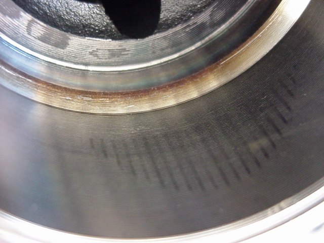

Here is the inner seal removed.
How pretty.
On jackstands:
This was the best write-up I found, but I read them all. This is specifically for models with ABS, which makes a little difference, well, it's just a little trickier to get the inner seal out on models with abs.
https://www.yotatech.com/~corey/tech...m1_oilseal.htm
It wasn't bad at all. I took my time and had a friend help me pull the axel out. I wanted to make sure I kept it real steady when pulling it out.
All the time as spent on cleaning up all the oil soaked stuff, wheel, drums, etc.
