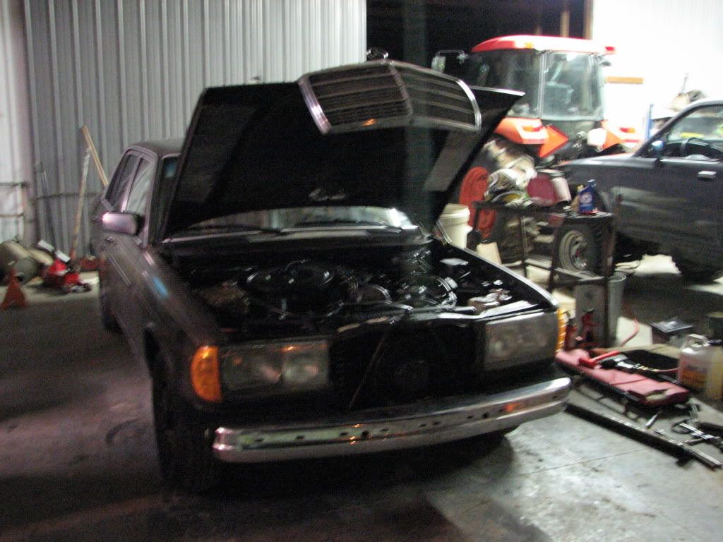

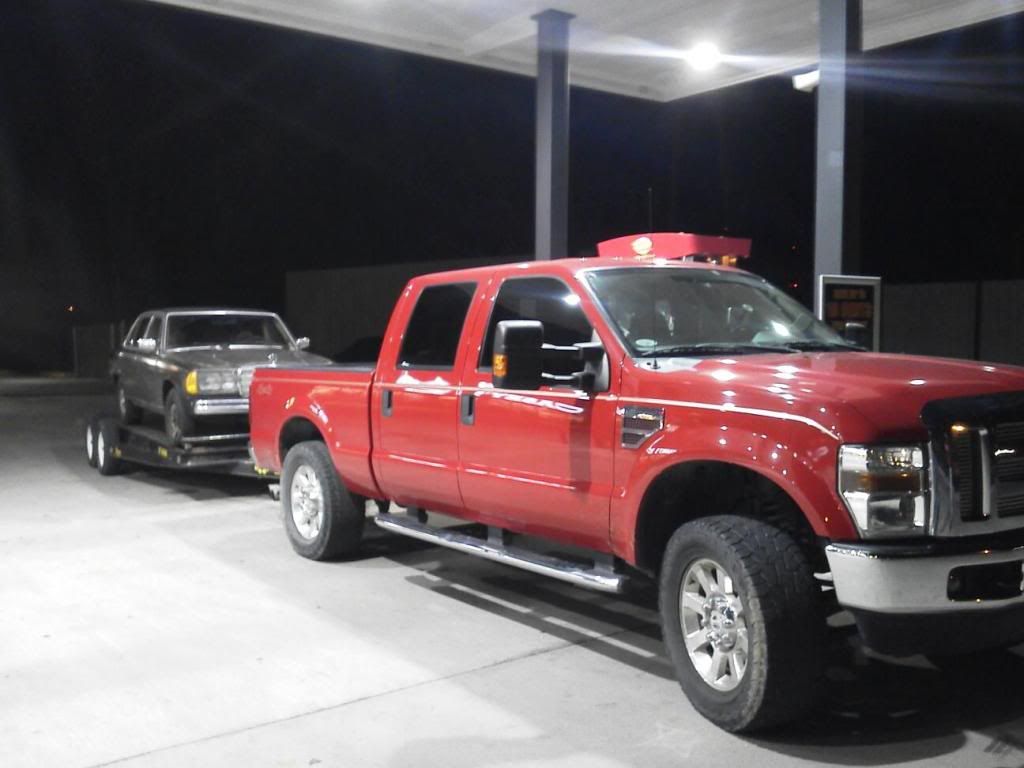

Hey Guys,
I am a long time lurker, but haven't posted much. My truck really hasn't given me any trouble and there are others that are far more knowledgeable than me about them. For a while now I have been thinking about an engine swap to get rid of the 3vze in my truck. I really wanted to do something unique so I decided on going with diesel, plus I'm a diesel nut (my other truck is a Power Stroke ). So I started the search for an engine. I found an 83 Benz 300D not too far from me for $300 so I brought it home. As it sits now I am going to yank the engine and go through it and "refresh" it because I want to know that its good to go once its in the truck as it is my DD. I plan to make my own adapter plate out of 5/16 steel and reuse the stock flywheel. I figured I would post up the entire build in detail so anyone who was interested in this swap or someone who is working on doing one can maybe get something from it. I know there are numerous threads on this swap but none of them seem to be very in depth or complete. It is not going to be a very quick process as I am a 21 year old college student working full time on a farm and running a mechanic/diesel shop on the side, so time and money can be tight at times. So here we go. Here is what I am starting with. Its a 1990 4X4 V6 5spd with 220k.
Here is the Benz on the trailer bringing it home.
A few more pictures just for S&G's
The 3.0 5cyl OM617 Turbo
I decided to go on and check the valves and re set them.
And that is where I am at for now. I may work on getting the engine out this weekend. I'll have to see what time permits me to do. My goal is to try to start work on the adapter by Thanksgiving. I hope this thread proves useful to someone and you guys enjoy it. If you have any questions I'll do my best to answer them.

Well today was a VERY crazy day but I managed to get the engine out of the car. I decided to take the trans too because the two Hex bolts that hold the starter on were in there real good and I didn't want to risk stripping them. If you are squeamish to car carnage I would look away now lol.
Thank you aviator for the tip on the hood. I did the valves last night and was ready to kill that darn grill! Keeping to the budget build I was too cheap to go but an engine hoist. The tractor and loader method worked pretty well, but I think that I may use a single tree to put it back in to try and level it a bit better. Time will tell on that one. I am going to try to part the car out eventually. I was hoping to get the engine on the stand tonight but I had a guy with a Dodge Cummins come in the shop wanting a trailer plug put int he bed for a gooseneck, simple enough right?, well the person who wired the trailer plug in the bumper used all one color wire so a 30 minute job took 2 hours. So hopefully in the morning I'll get it on the stand and be able to get the car out of the shop.
