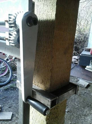

rustED April 25, 2017
First i took an old torques T50 3/8 drive socket and cut the torque end off. Then I welded it to the shaft that the original handle slides onto. the socket is small enough that the original handle can still slide over it and be used*
