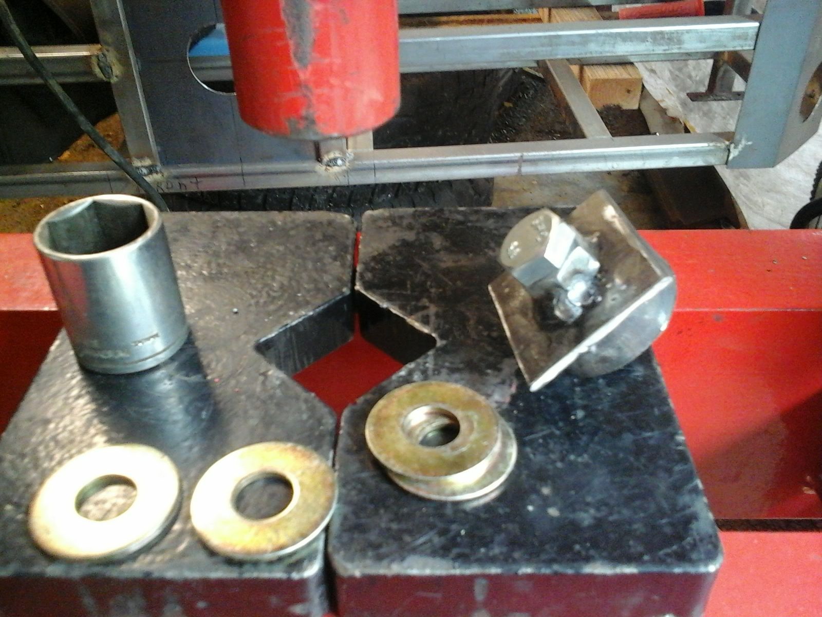

I basically welded a nut to the bottom of a square peice of plate steel. Then I welded a peice of tubing to the other side. Then threaded the bolt up though. I just happened to have the right size flat washers, so I used them as spacers and stacked them up inside the tubing until I got the depth I wanted
