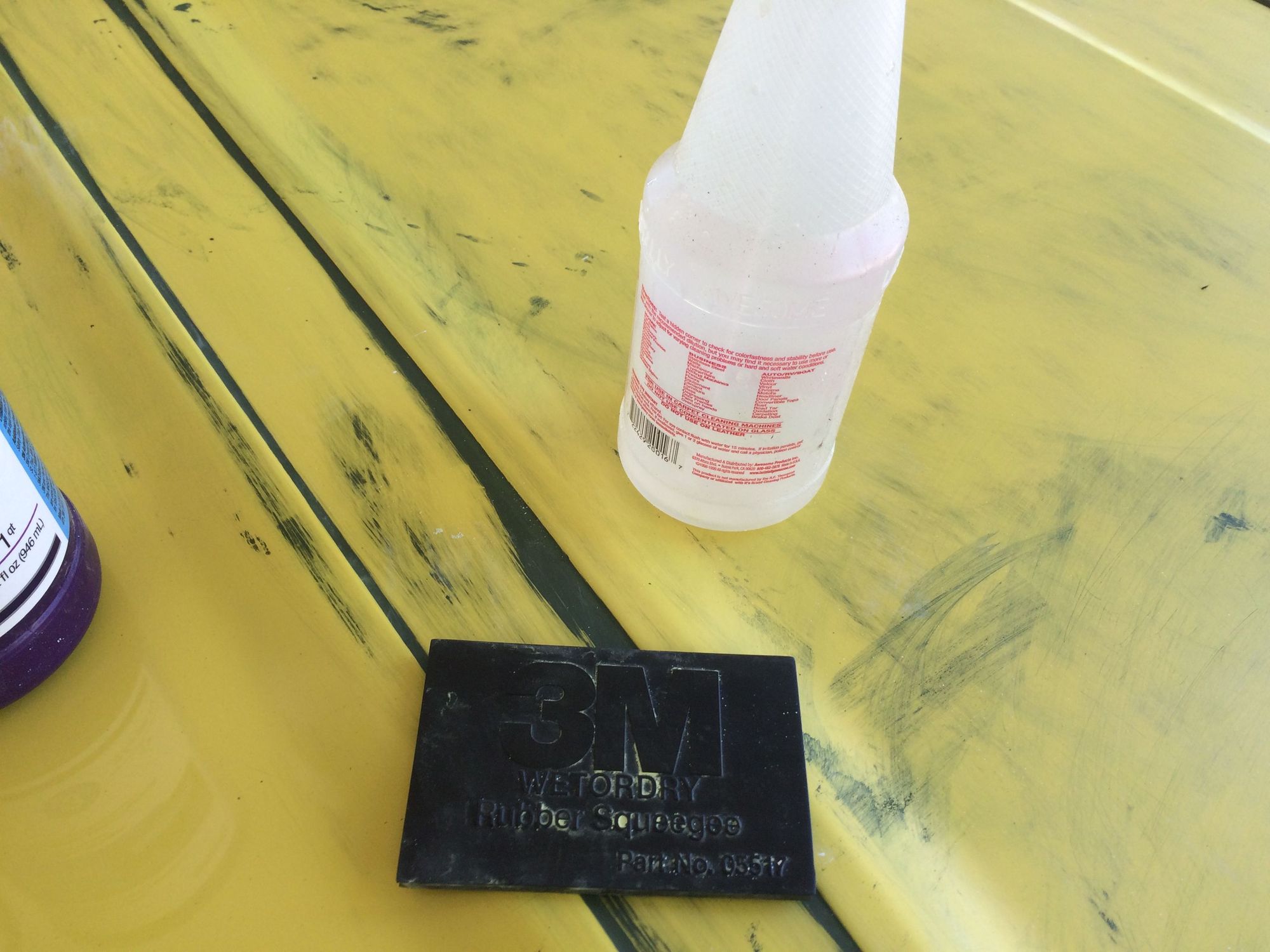

A drop of dish soap in a spray bottle with water help by not making such a mess as a bucket full of water. The small amount of soap helps lift the old paint away from your work area. A 3m squeegee is great for keeping the area your working on free from debris and helps you see where you need more sanding. Normally I would use an engineering fluid called Dykem between grits but I can see well on this color without it
