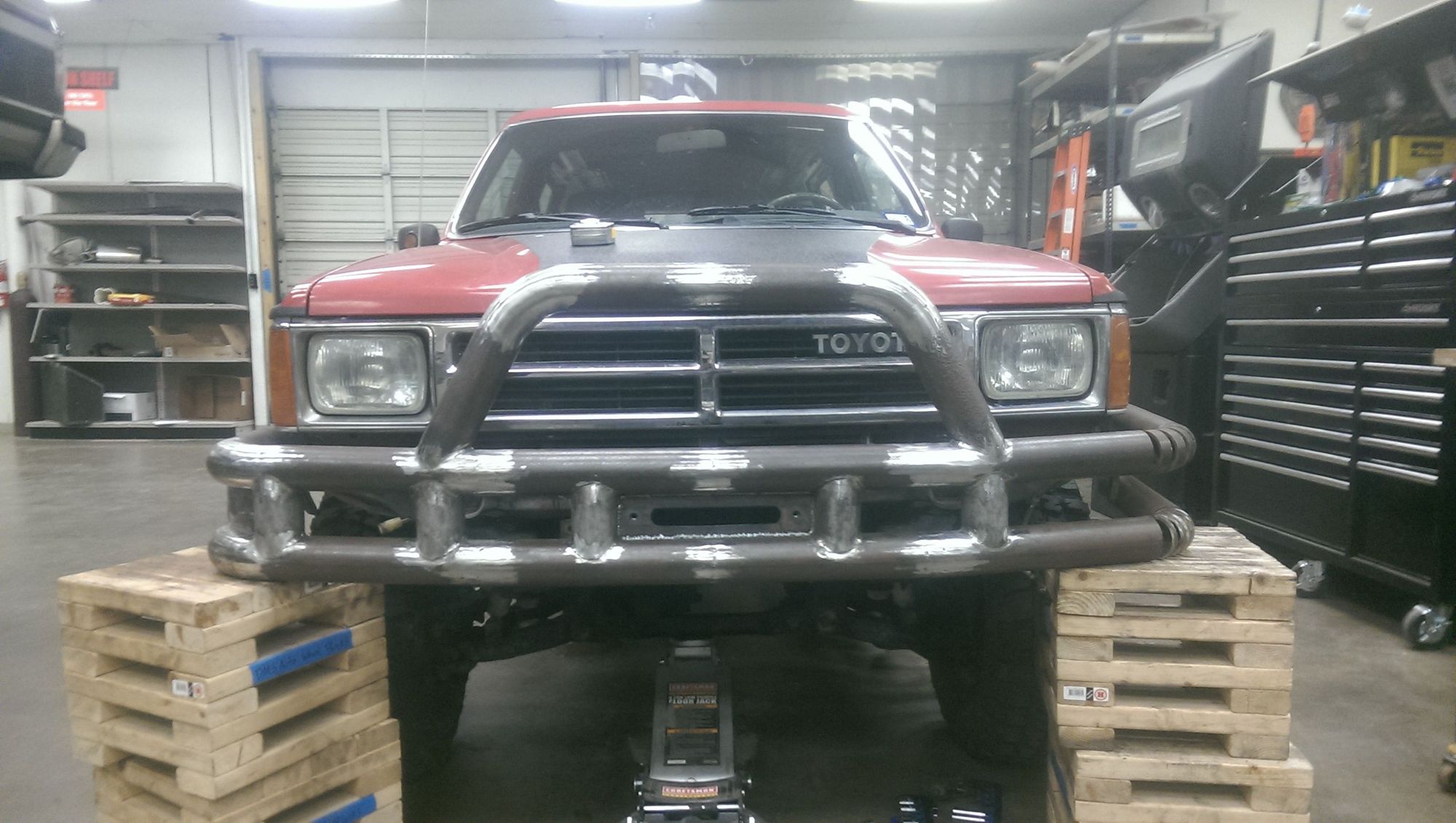

looks ready for some zombies. I didn't have the right jacks to get the bumper at the exact height and level, so I put it on these blocks and lifted the front end of the rig up so it was in place. For the final weld up when tacking on the winch plate and other supports, I think I'm going to hang it from an overhead gantry with the now infamous red ratcheting straps so I can get the whole thing perfectly level and square to the vehicle (jacking up the front end threw off the angle).
