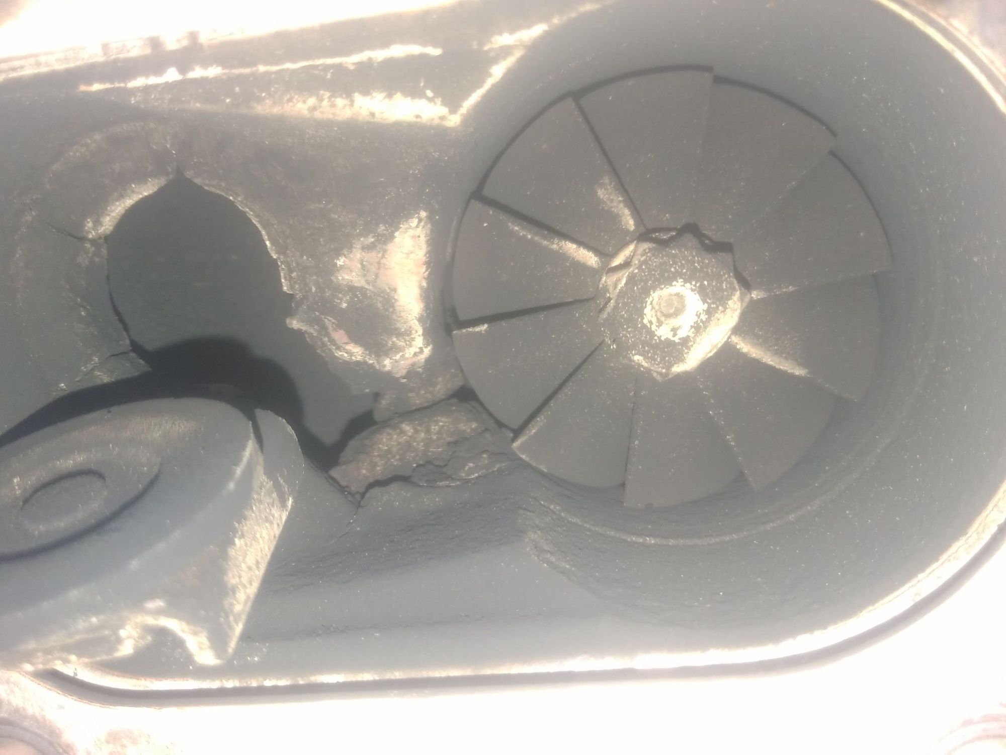

Here is what happens when that little crack opens up. Also worth mentioning you can not see all of the crack with the housing in place on the center houa
