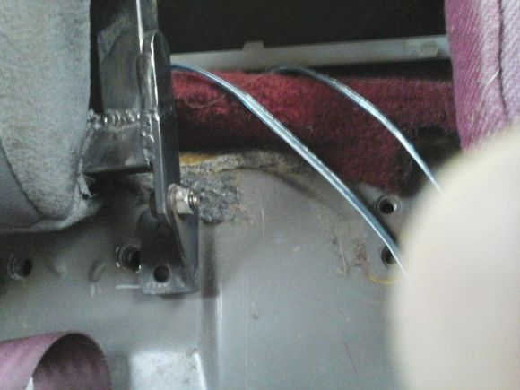

Here is the hinge after moving it in 4 or 5 inches.The floor contours in right where the hinge bolts to the floor, so i made a 1/4" thick spacer and welded to the hinge. The spacer was wide enough that I was able to use th seatbelt hole to bolt it dowm.
