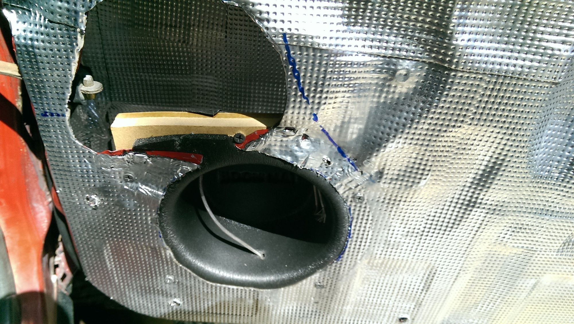

you can see the blue sharpie window crank gear swooping line as well as the door hinge stop line. 3/4" MDF "Ring" and "BoomMat" 6 1/2" foam baffle covered in BQuiet installed with coated deck screws
