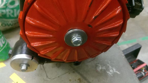

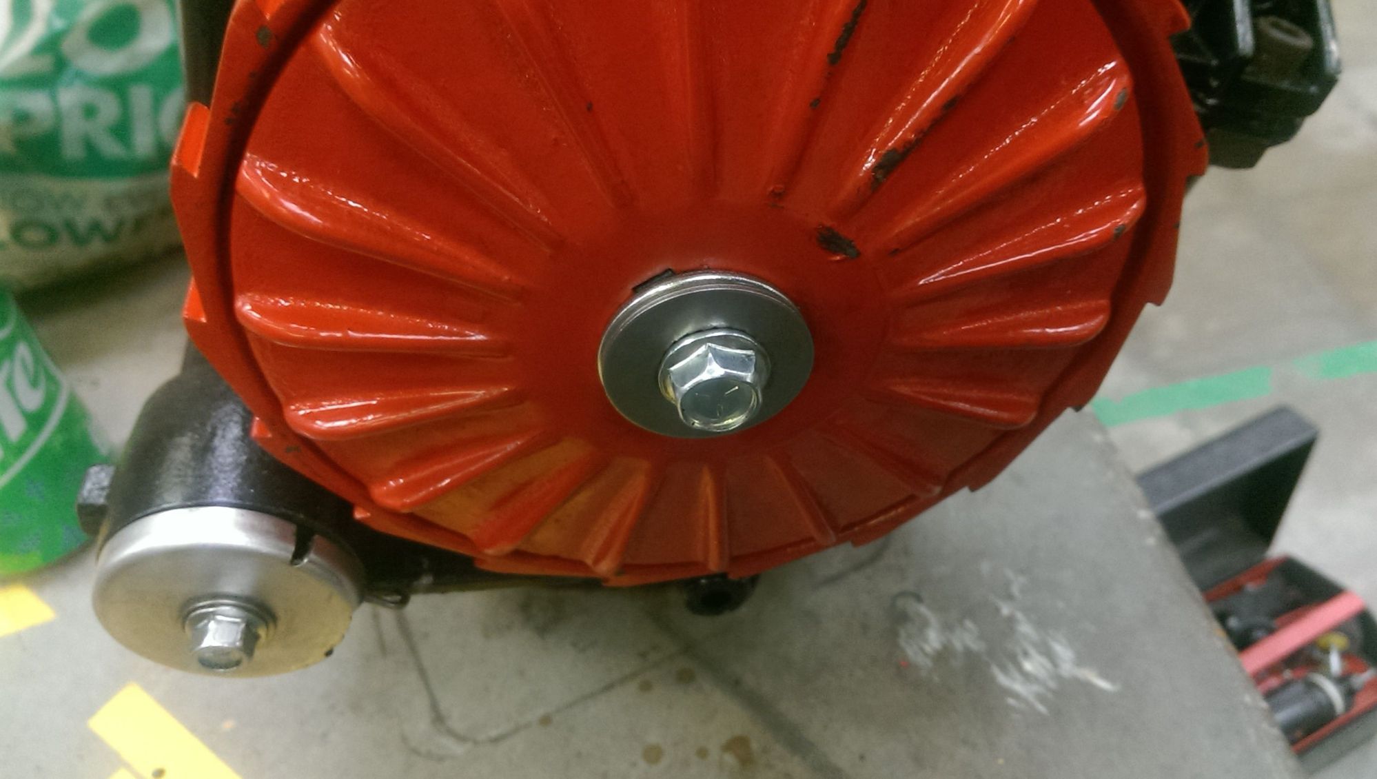

I've heard one of the main points of failure is the break retaining clip popping off under a load, so I chucked it up in the lathe and drilled and tapped a 5/16" bolt into the end and turned off the other part I didn't need
