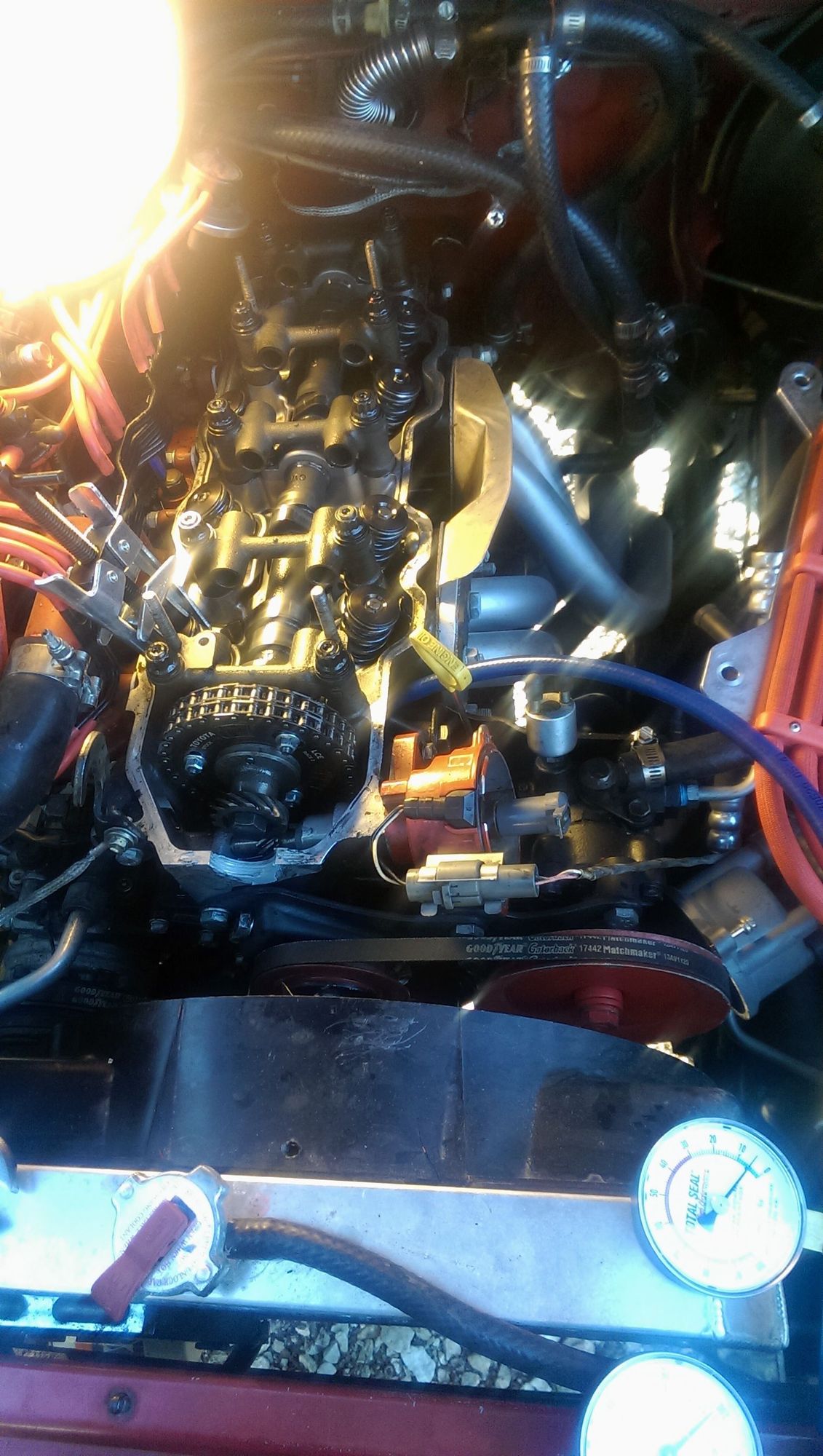

Intake side of the engine was pretty tight without removing the intake, but I managed....notice new cam sprocket set to "0".....I used the degree wheel to advance it to accommodate for the decked block and then advanced it slightly further to lower the power band into the lower RPM range
