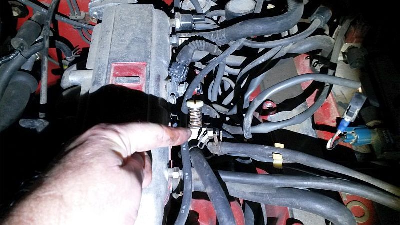

this is the idle adjustment valve if its working when the VSV is activeated it allows more air into the engine bypassing the throtlle plate causing a controled increase in engine rpms which keeps the AC compressor on as it will cycle off at normal idle rpms but not around 1K rpms the white adjuster is how you adjust the AC idle and also works with the power steering if its loading the engine
