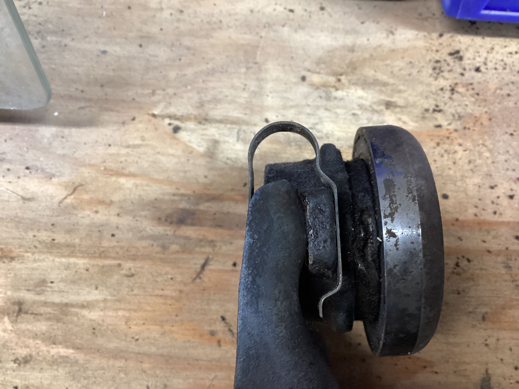

Top view with the back of clutch fork on the left side. The clips have a curly q on one end which fits into a depression in the back side of the fork while the other end wraps around the ear on the clutch collar holding that in place. The clutch bearing (on the right hand side in this pic) is pressed onto the collar with the round face of the bearing facing the engine.
