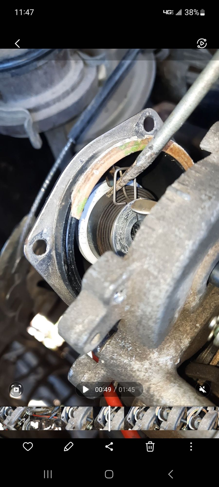

Chick-N-Picker January 6, 2026
I actually did take a video of this but I think the picture and description show it fine. The bracket with the blue arrow goes where the pick is in the spring hole. Make sure the bracket is on the passenger side of the coil tab.
