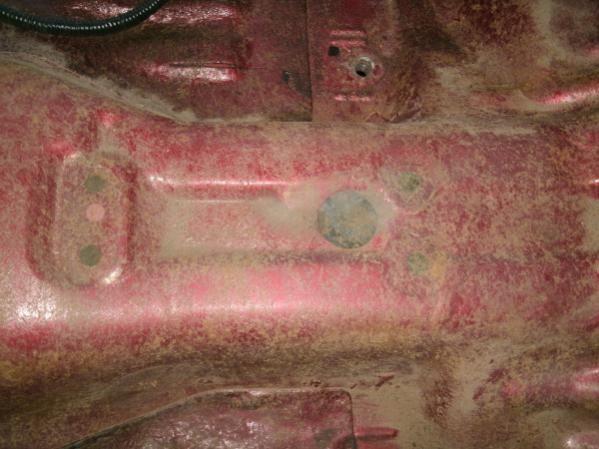

Here you have a good view of the console places to drill through, in the upper section is the "flat" for a conversion from bench to bucket seats.. This is a 1994 model year, yours maybe different but similar they used the same style (one stamping with holes drilled and blind nuts added depending on build spec)
