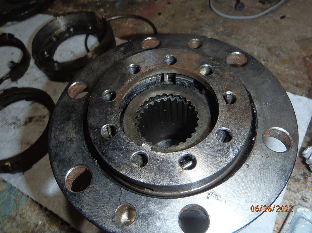

another angle - note the tab on the lock ring. this rides in a groove on the spindle, and will be at 12 o'clock. the knockout pins are aligned the same, although from this view, 12 o'clock is at the bottom side of the picture
