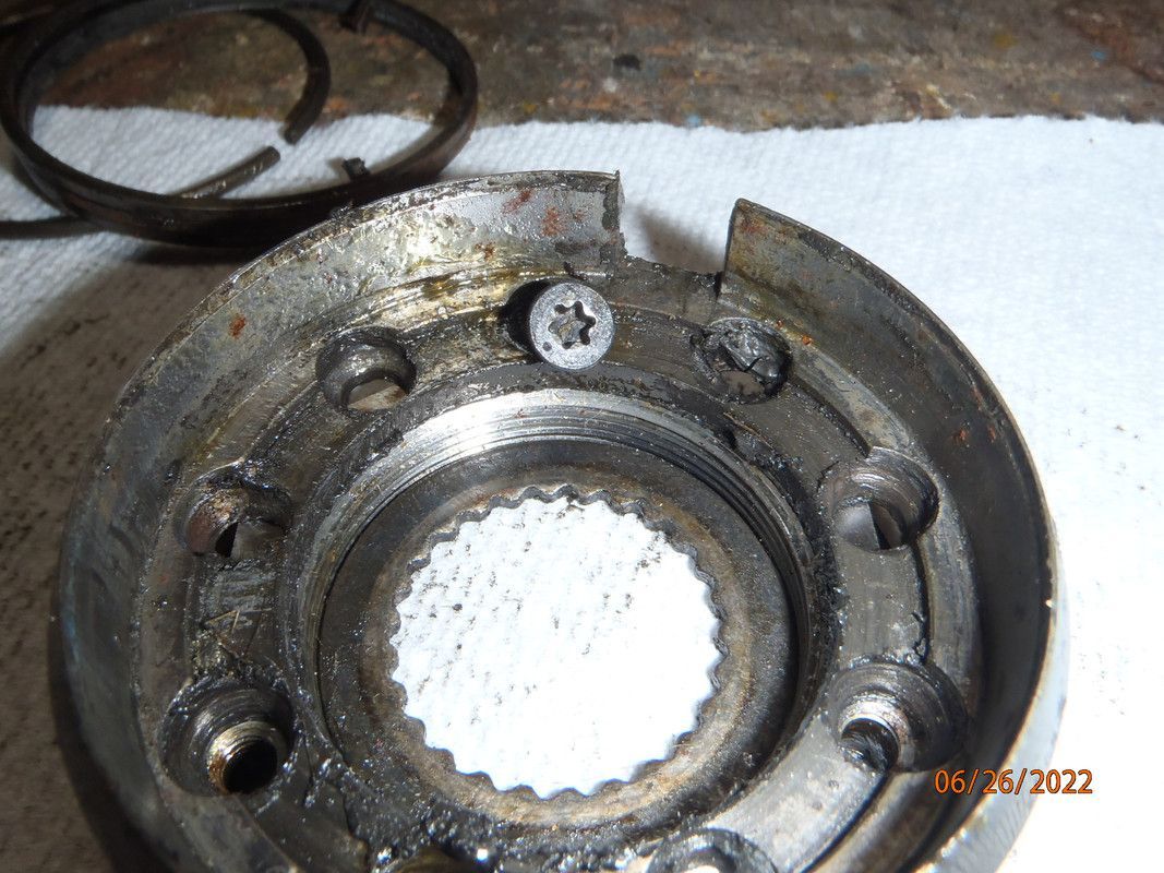

one of the three torx head screws that hold the 54mm bearing retainer nut in place by securing it to this lock plate. only three holes will align at once to mate the two. they have offset alignements to allow for differing load needed to set to spec. there are "three sets" of 3 holes.
