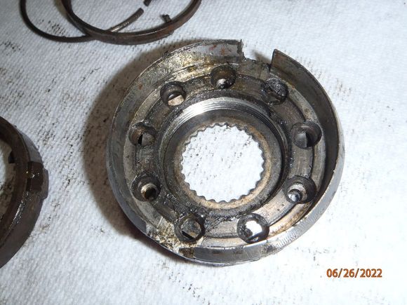

wallytoo June 26, 2022
with the brake spring assembly out of the way, the lock plate can be seen. the washer in the center can now be removed, too. again, picture the stub shaft and spindle shaft protruding through the center. the serrations on the washer allow it to slide onto the stub shaft splines.
