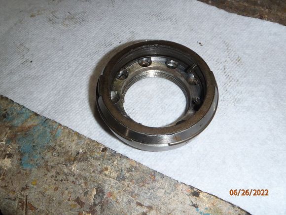

this is what you'll see when the locking hub body is removed. this brake assembly rests within the wheel hub. imagine that the stub axle and spindle shaft are protruding through the center. you have removed the stub axle snap ring
