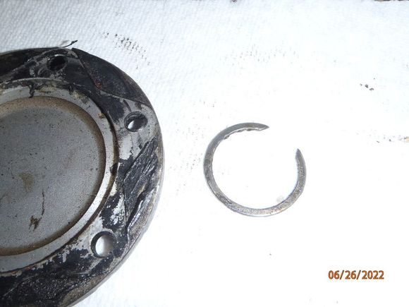

the snap ring that holds the brake portion of the locking hub system to the stub axle. use a small flat-blade screwdriver to pry this off of the stub axle
