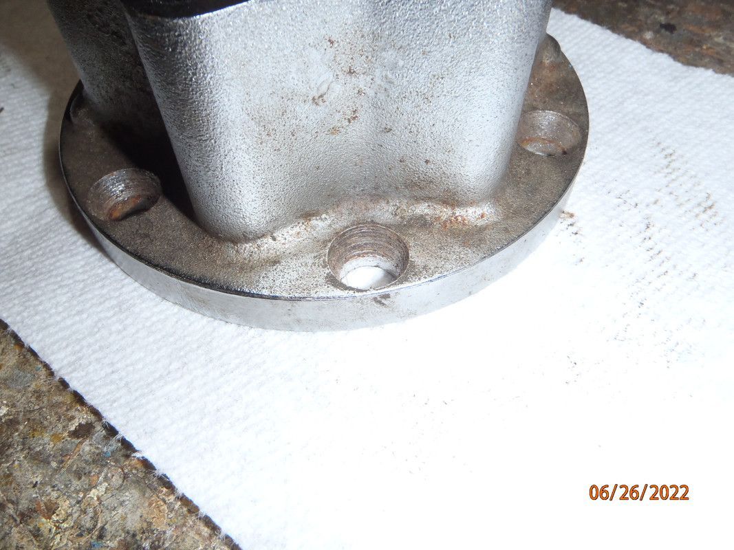

the recess in the hub body where the cone washers seat and the wheel hub studs protrude. the locking hub body is secured to the wheel hub via the cone wasers with the studs running throgh them, and then a lockwasher and nut (12mm) on each of the six
