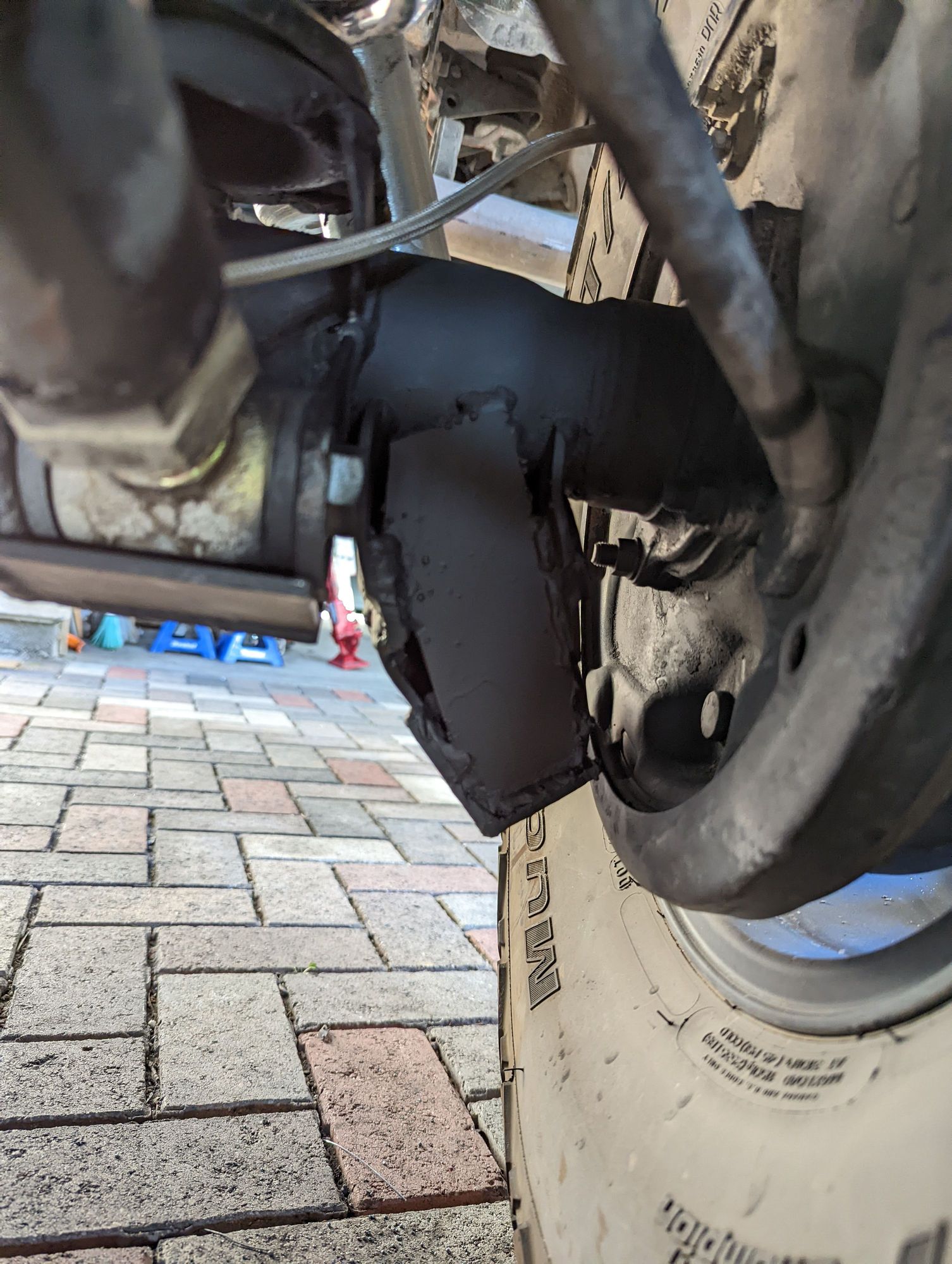

Several issues. With the longer control arms and change of angle of the axle (double cardon driveshaft joint) THe tock angle of the lower shock mount was not working. It was stressing the shock. Had to reset to center at ride height. Initially was gong to rip off axle and redo everything, but saw this as a strong alternative. ALbeit not super clean. I strengthened it with that added backplate.
