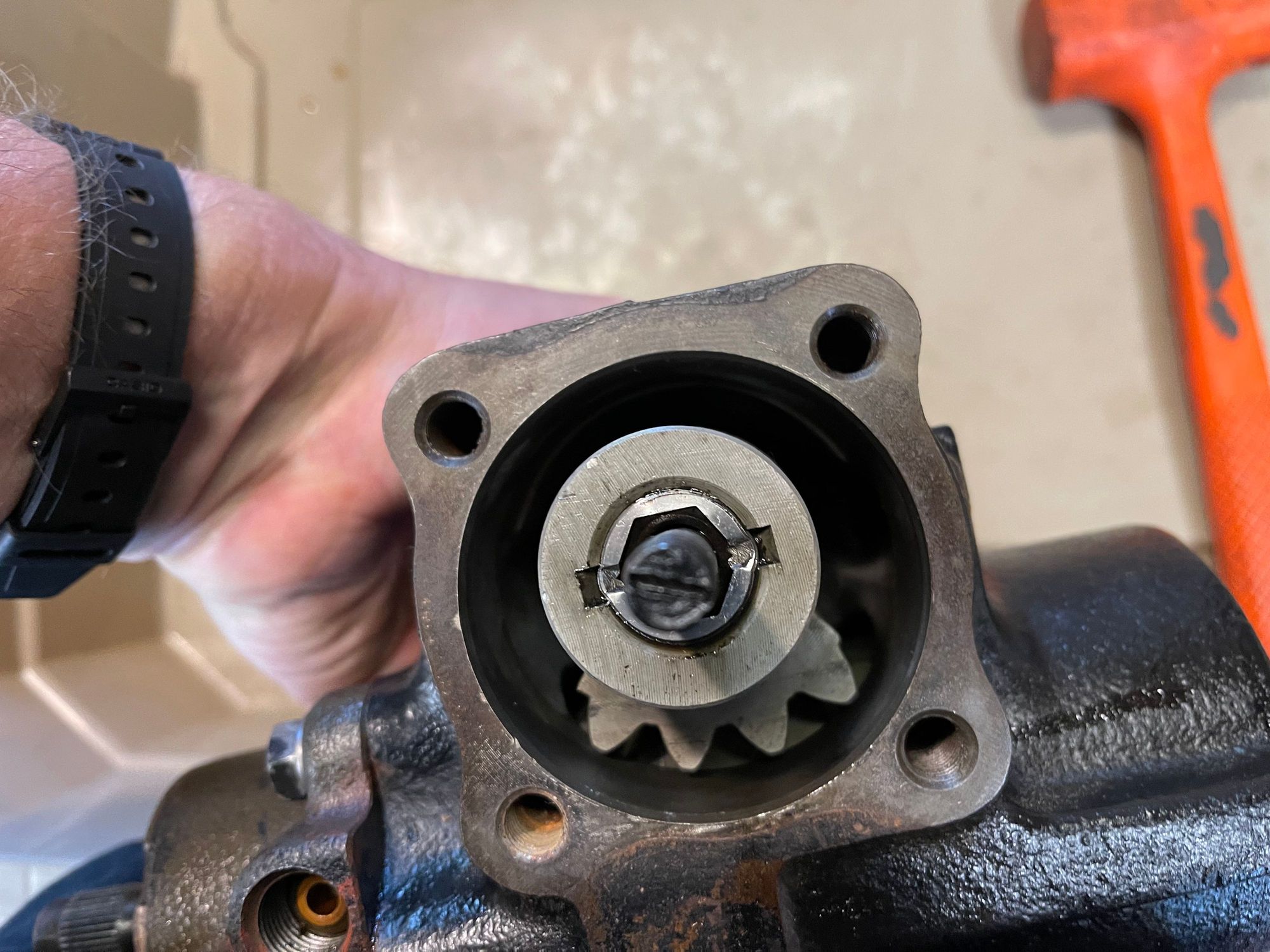

Grease the teeth on the power piston and sector shaft and where the seal rides on the shaft. Now center the sector shaft teeth and drop it in. Turn the box upside down and allow its own weight to push it in.
