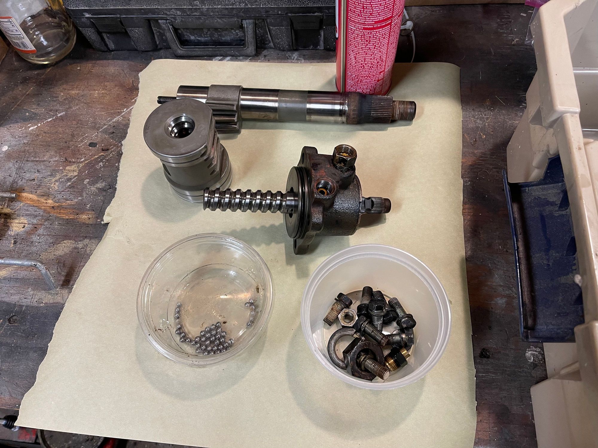

Unscrew the input shaft from the power piston. Bearings will fall out! Clean everything. Spray thru the valve control with Brakleen and make sure movement is smooth and not loose. If yours is leaking around the input shaft you will need to disassemble further to change the seal.
