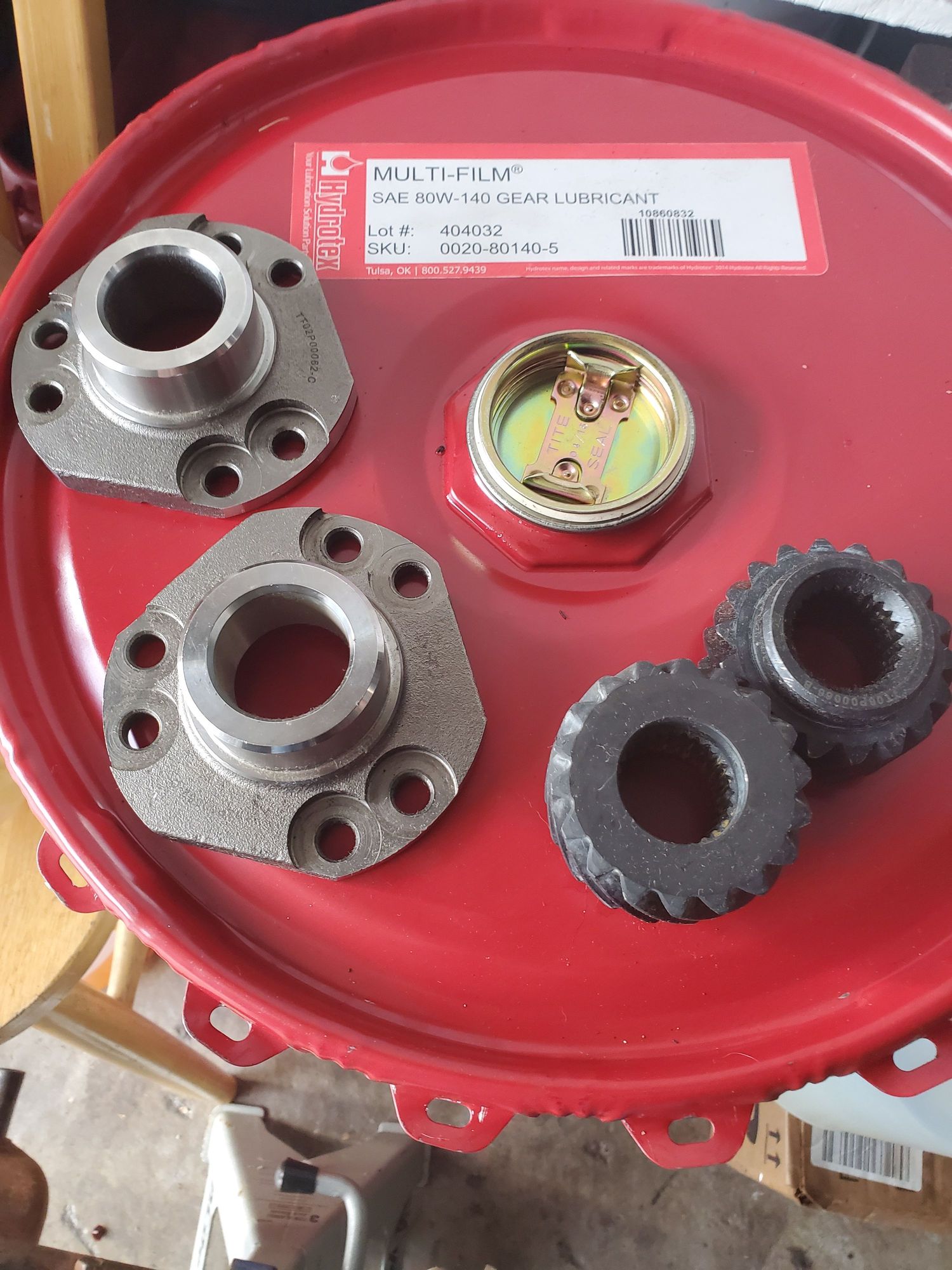

Hub Journals on the left. Side gears on the right. I.D. of the journals needs bored out to accept the bushings from ECGS and the side gear spines need shortened from the inside part of the side gear (material removed from the side facing the inside of the diff, The side gear closest to the bottom of the pic)
