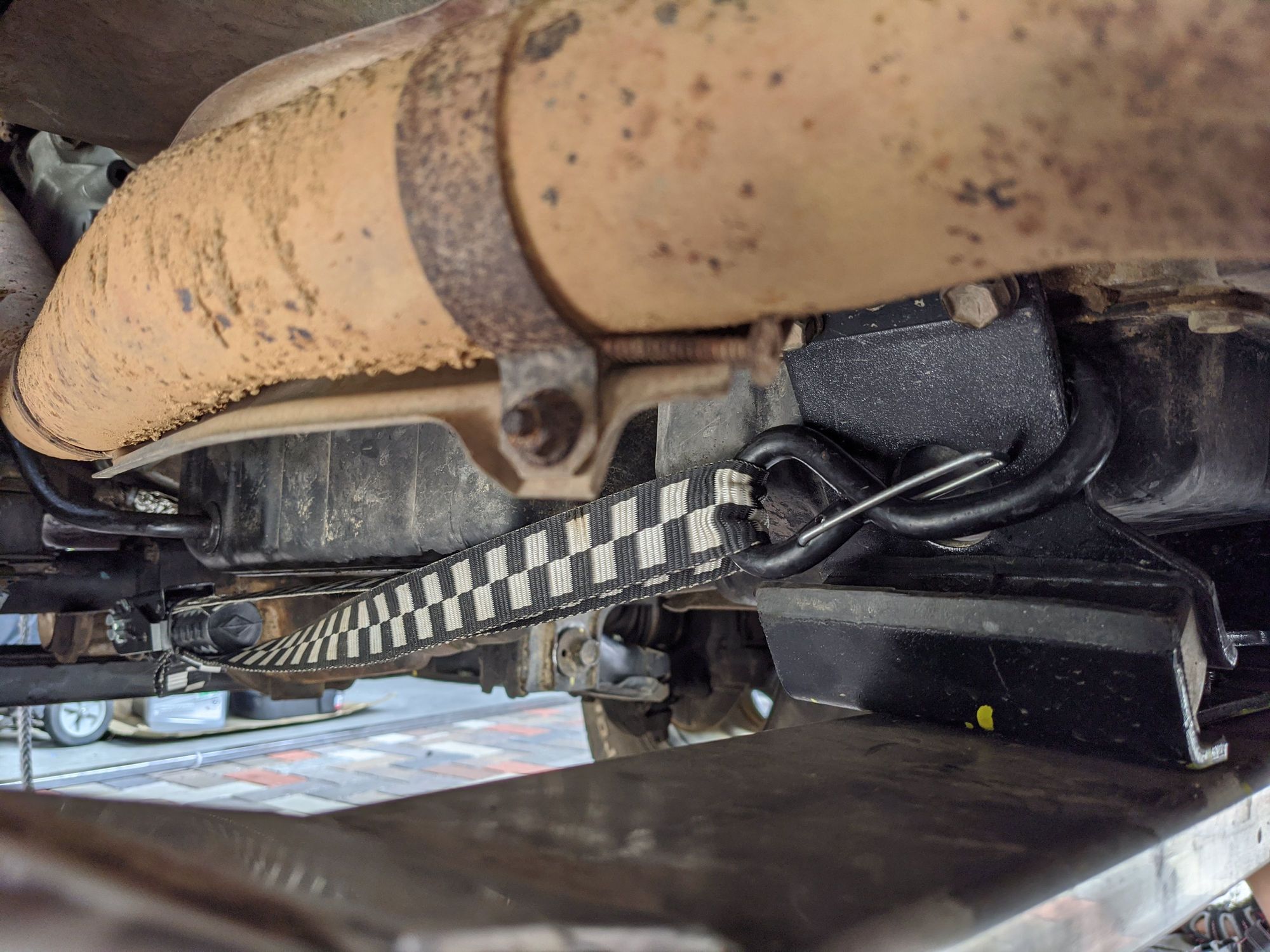

Same problem with the tranny mount, totally shot. I replaced it as well. You will notice strap. lol. The engine and tranny had moved backwards by 1/2, i thought the bad engine mounts caused it. I think lifting the suspension changed the angle and pulled the drivetrain backwards. I made my crossmember holes in stock location then had to slot them. Got to figure that out...
