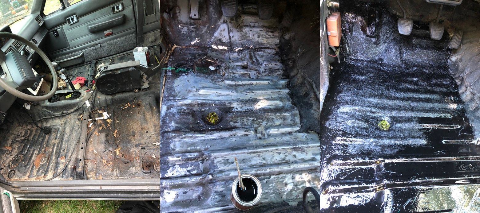

had to chip up some unprepped bed liner, clean rust with wheel, then prepped with POR15 cleaner/etcher, laid it down with cloth on drivers side where it was bad. not professional but pretty rock solid.
