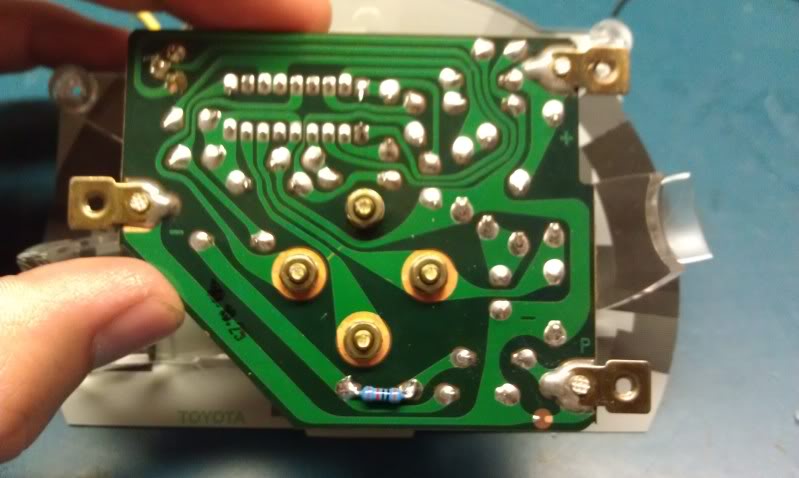

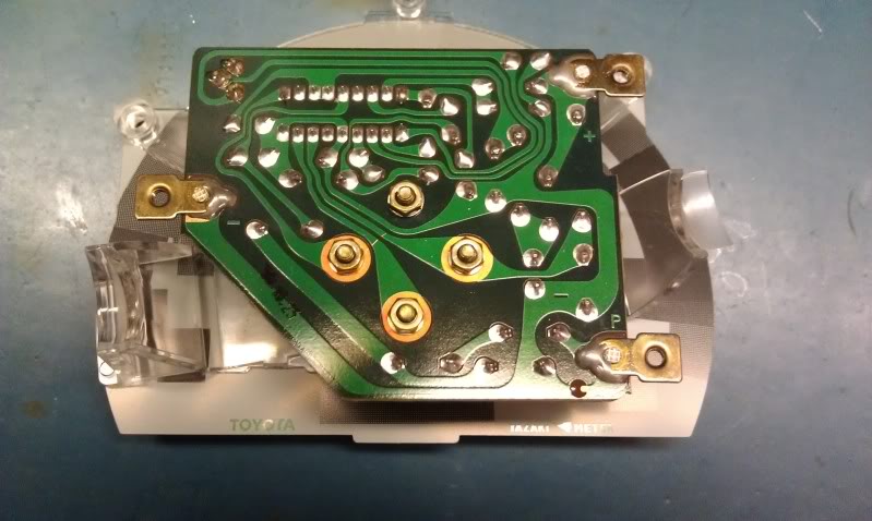

Main problems now are the tach and cruise control. I suspect that if the tach worked I would have a better chance of getting the cruise to work. I have seen here that the tach signals may be different for the 98Taco and the 95PU. I pulled the dash apart yesterday to see if I could see where the 10K resistor should be spliced into the printed circuit for the tach, but my printed circuit covers the entire back of the instrument cluster and is nothing like the standalone printed circuit picture for the tach I have seen on this site. Can anyone out there who had a similar problem help? Thanks!!

From my swap thread (https://www.yotatech.com/forums/f160...post51920955):
Bare, unaltered tach:
with 10K added:
Hope that helps with your tach question, I didn't swap over any cruise control stuff, so I can't help you there.

Thanks Sacrunner - I saw your post before (with the pictures)!! But my printed circuit is about 16 inches long! So NOT the same.Thanks for your reply.

Sacrunner - After more digging - I found your solution was TOTALLY right.The printed circuit I was looking at was for the instrument cluster lights? I put in the 10k resistor - tach works great now. Thanks again.
Dave
