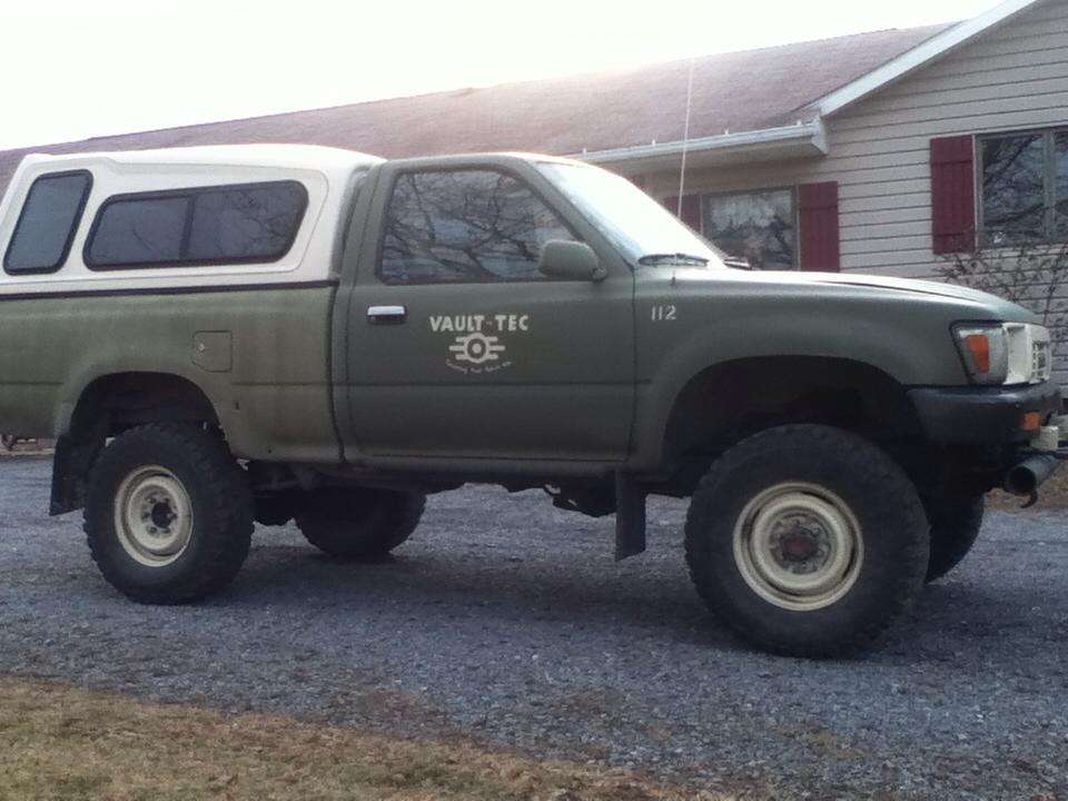

I say if you're gonna install BJ spacers and then loosen your t-bars and drop the front back down 1-1.5", no need to touch the rear. My truck was super flexy when I did that and removed my swaybar blazen8 of blazeland has shown a bunch of research here on IFS and says skip BJ spacers, they're kinda pointless...I don't disagree with this.
I like the "Vault-Tec" logo. Awesome game
