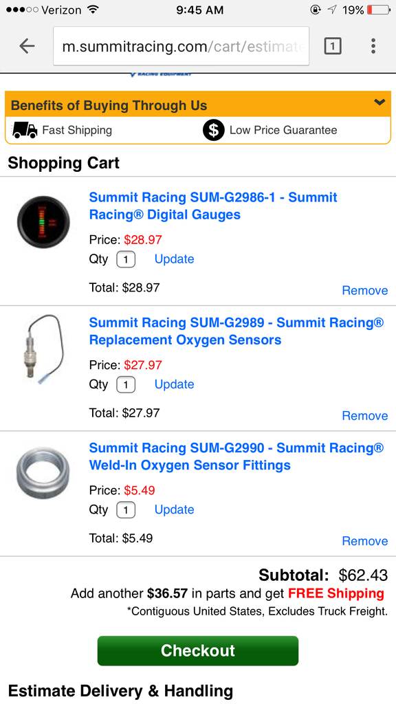

Just wanted to share this everyone in case anyone else had thought about doing this. I was never confident I had my Weber carb tuned as well as it needed to be so I wanted a way to verify and monitor how it's runs (I do low voltage HVAC control work for Trane so this right up my alley). I found a simple A/F gauge at Summit Racing that was fairly cheap and really good customer reviews so I have it a shot.

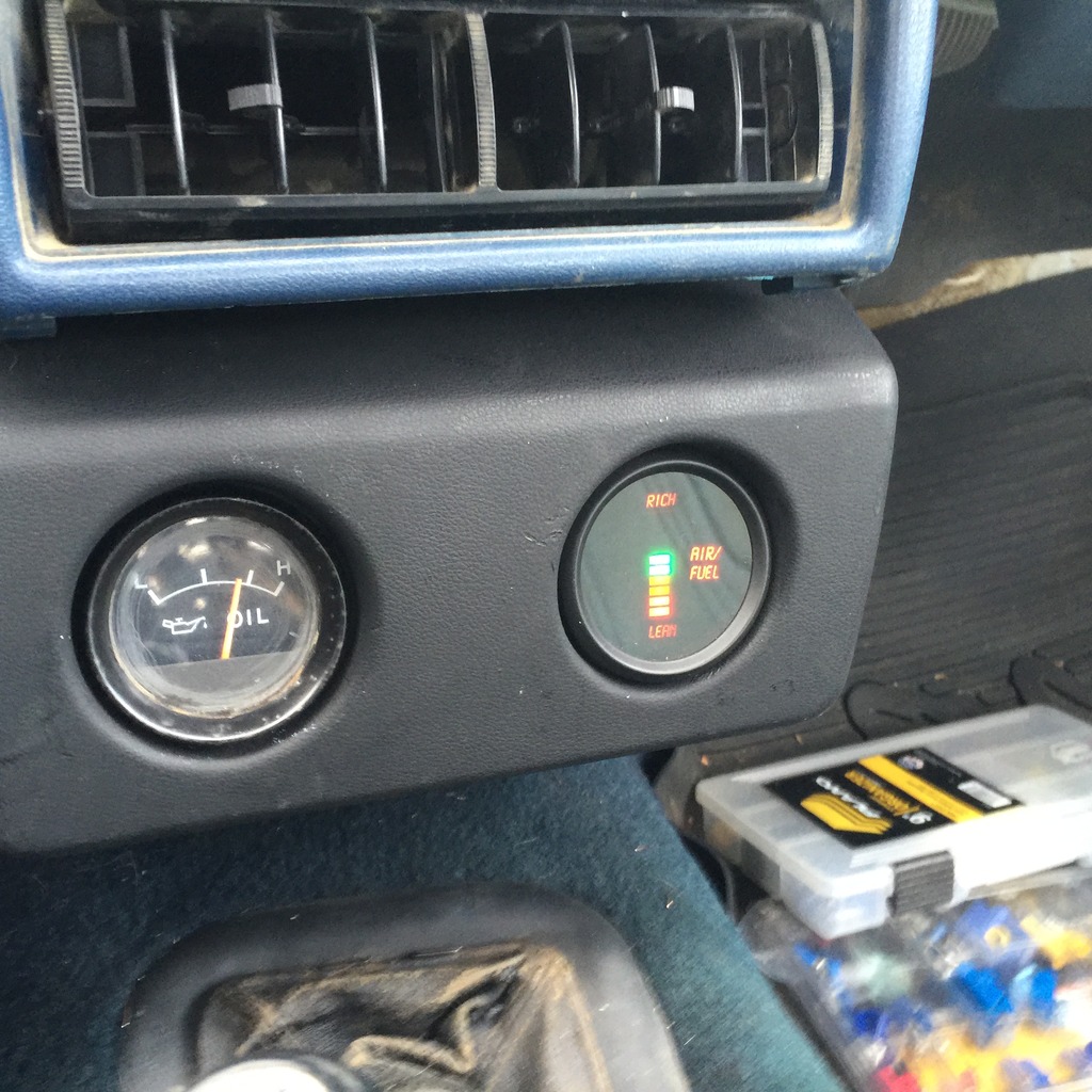

I thinking ship was $10 so about $75 total rounded up. The best part about this gauge is it fits in the SR5 oil/voltage pod. I had bought one off eBay years ago and never installed it. I removed the volt meter (already have a different one in my overhead console) and put the gauge in its place. Also wired up the oil pressure gauge while I was at it.

Personally I love this, I was able to get my carb tuned in pretty well (still doing fine tuning adjustments and trying different timing settings with it) and see how It runs at ~3000rpm where I typically run it.

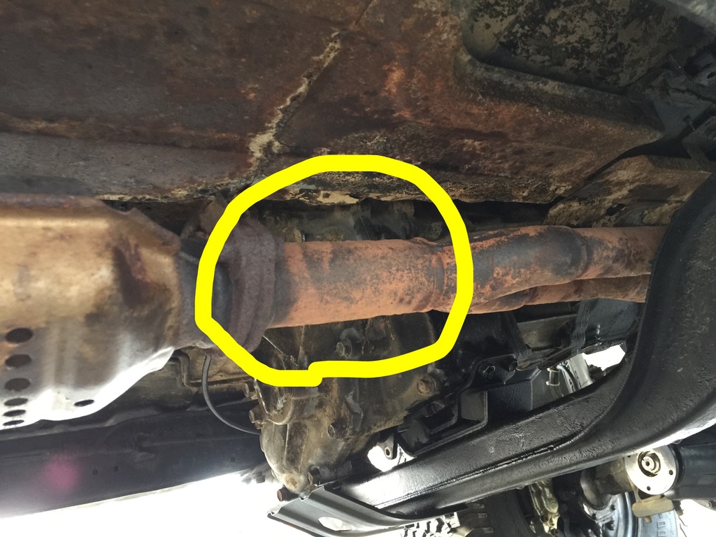

As far as wiring it was only 3 wires. An ignition power wire, a ground, and a wire for the oxygen sensor. I had a buddy weld up the sensor fitting for me in just a few minutes. We located it right here:

I think I would have gone with a new pipe .
Why did you not use the Toyota Style AF sensor and the bung with the studs .
I have had those threaded ones after trying every thing ended up cutting them out.
I would move where it is dryer but I don`t care for the heat.
