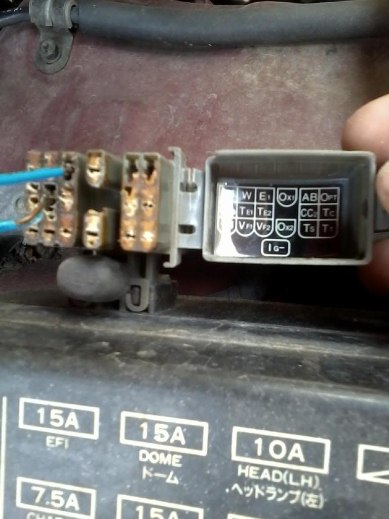

A paper clip makes a great code reader. The wire is just what I used to show how to jump the terminals. I dont have any suggestions to your revving problem but am intrested in what it is. Could still jump the terminals and see if there are any codes. CEL isnt always going to stay on.
Codes... http://4crawler.com/4x4/CheapTricks/...es/index.shtml
How to get Check Engine Codes. I just put this up for others. Applies to 87 and up. 86 and older is the bottom picture.

Wow, you guys were right. I tried the jumper and got a 41 code which is the TPS. I was going to disconnect it and what do you know. I didn't tighten it down when I was putting everything back together. I tightened it up and it works great. Thanks to Sparks and Terry.
