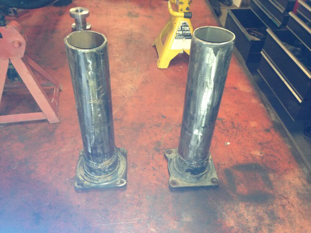

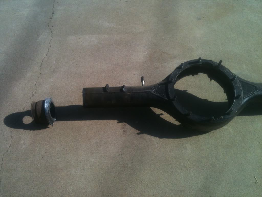

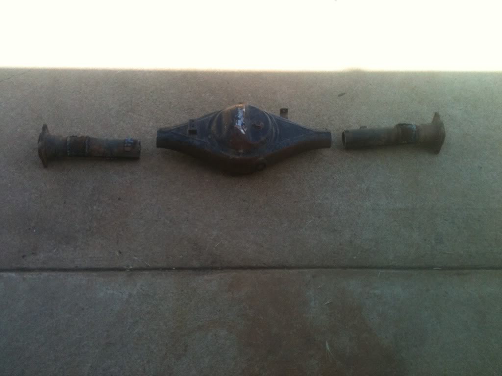

Cut the brake flanges off the end of the land cruiser tubes. One side will be longer .

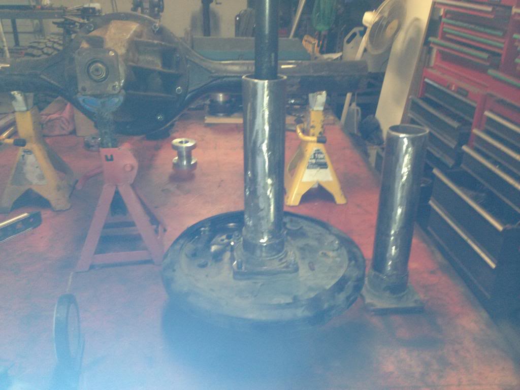

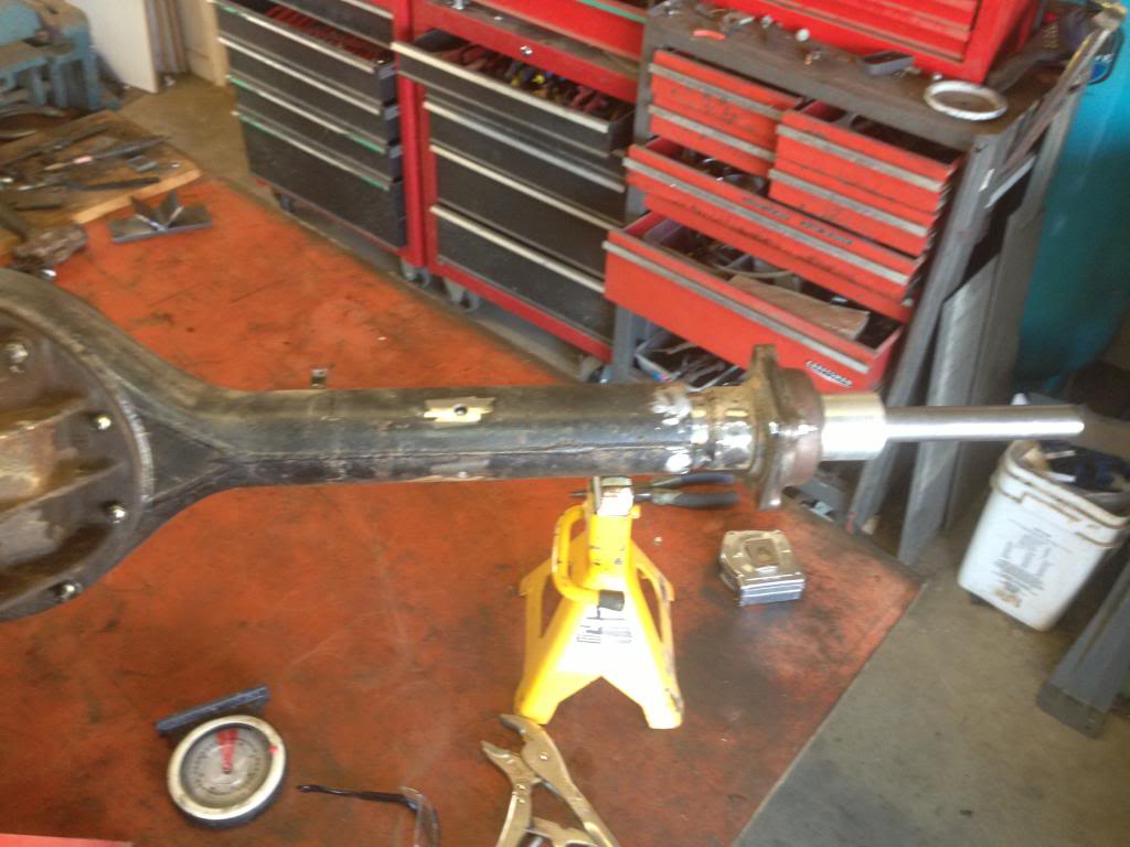

Cut the end tubes off a 1985 toy truck housing before they taper bigger.

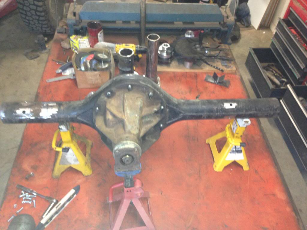

bolted tubes and axle on

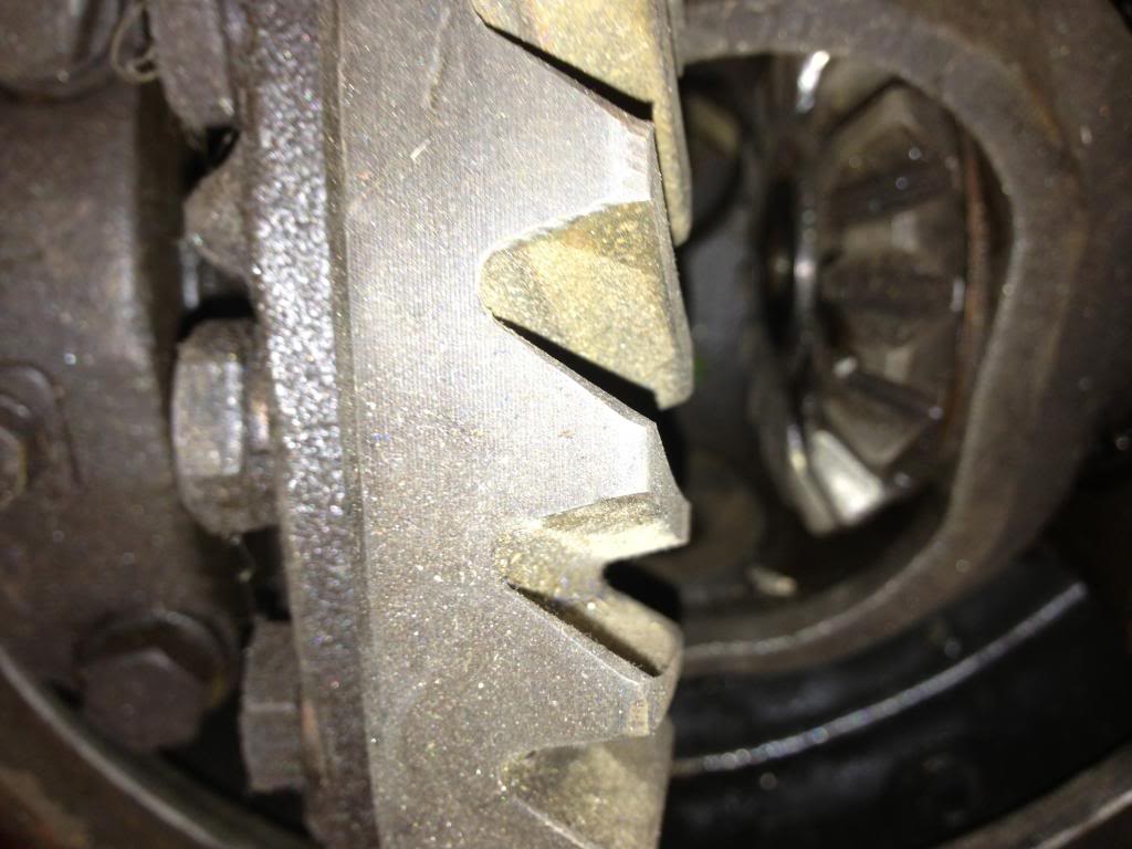

Slide into fj housing and stop when splines come to end of spider gear.

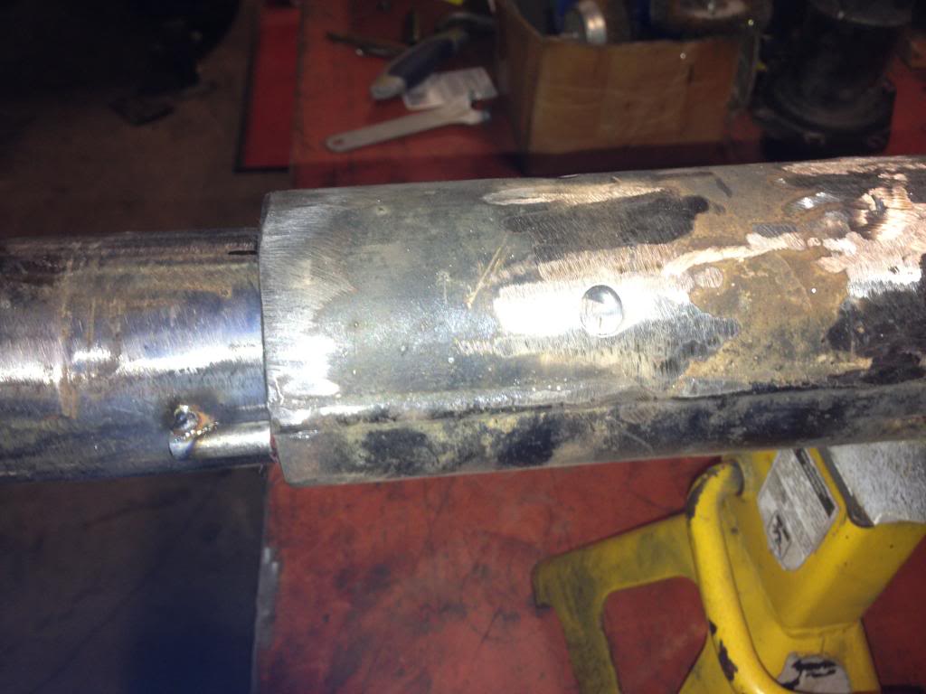

Welded a stop to the 85 housing to set the depth of the tubes. Also you can see i drilled some holes in the land cruiser housing to weld in and keep the end of the tube strong and centered.Name:  IMG_1108_zps8945d038.jpg

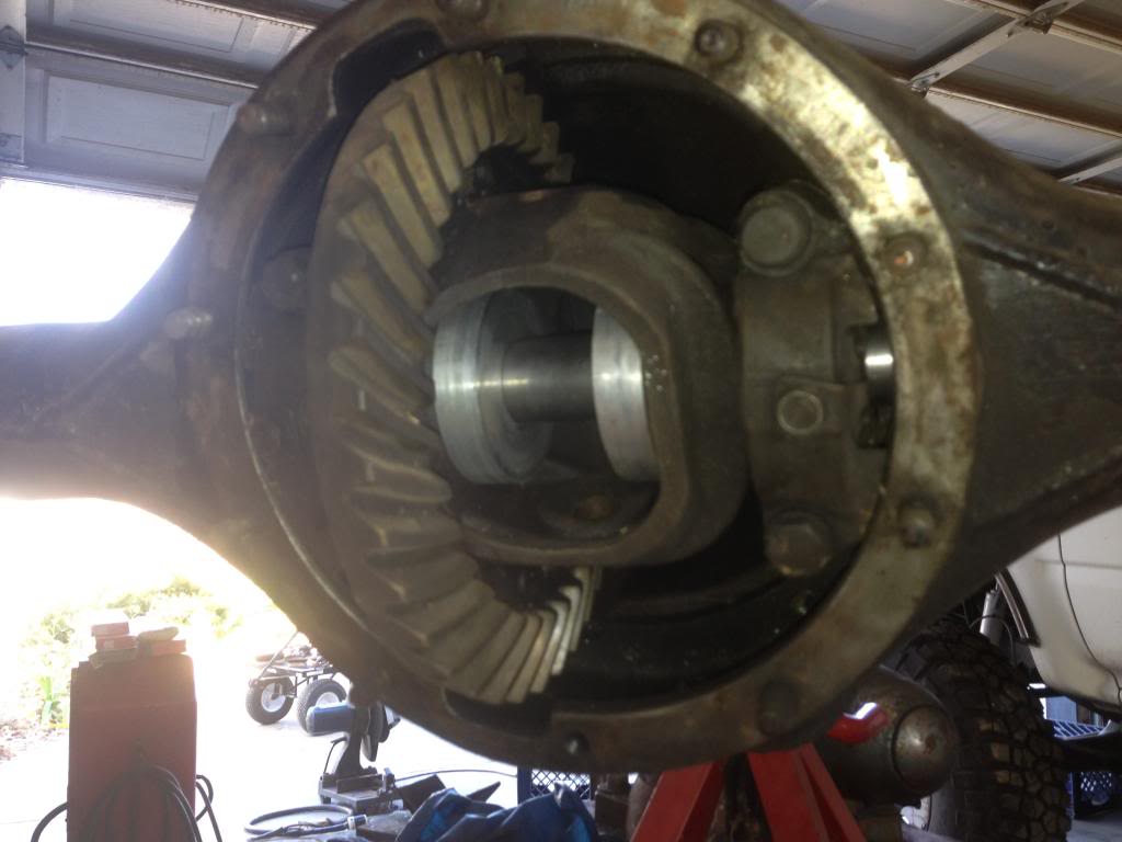

Took out spider gears and put in some spacers i machined for a 1 1/4 alinement rod to line things up.Name:  IMG_1115_zpsc3e3f00f.jpg

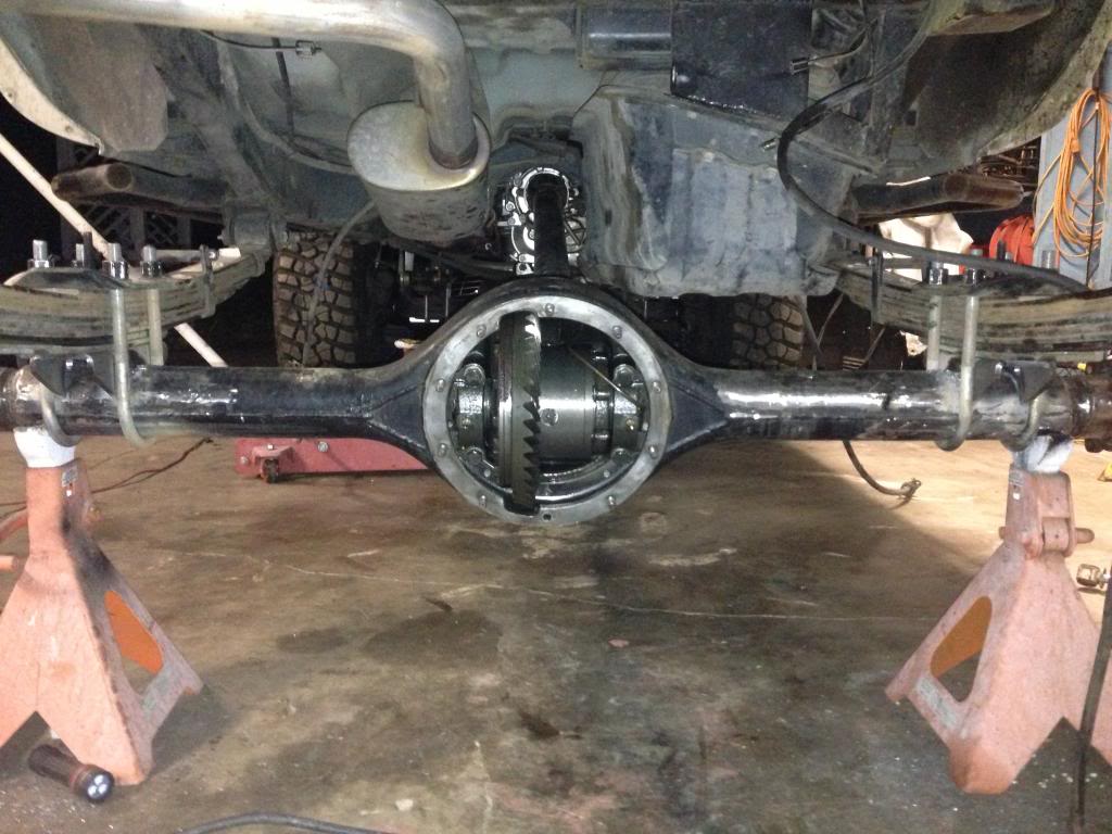

Put it under 4runner and welded up spring perches and shock brackets. Still need to finish welding and painting but i couldn't wait to post it up.
