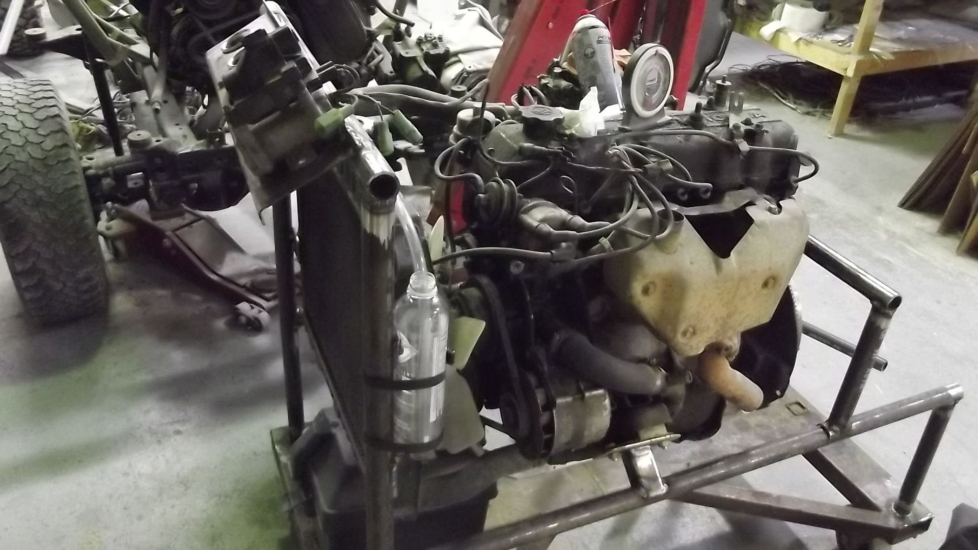

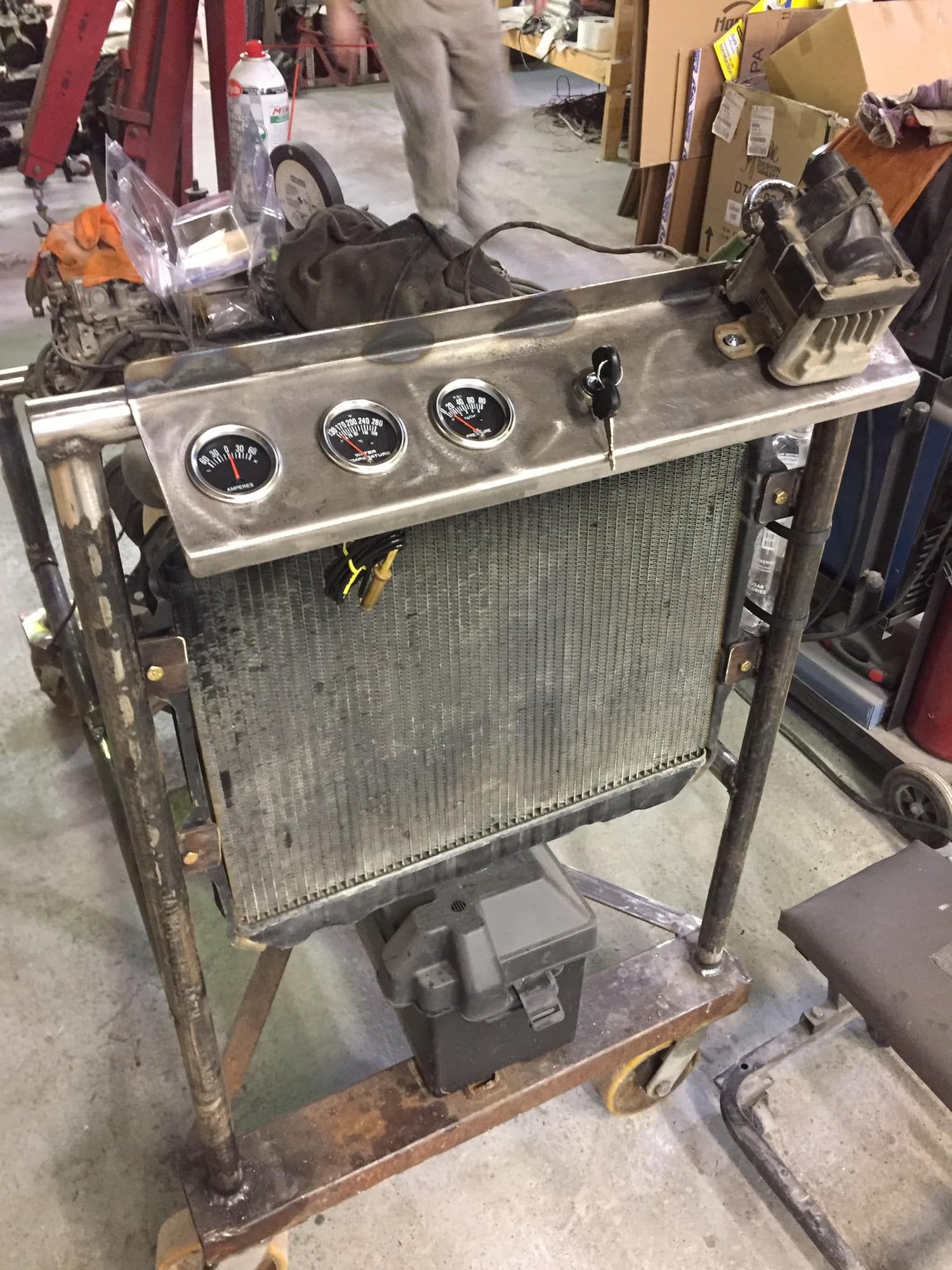

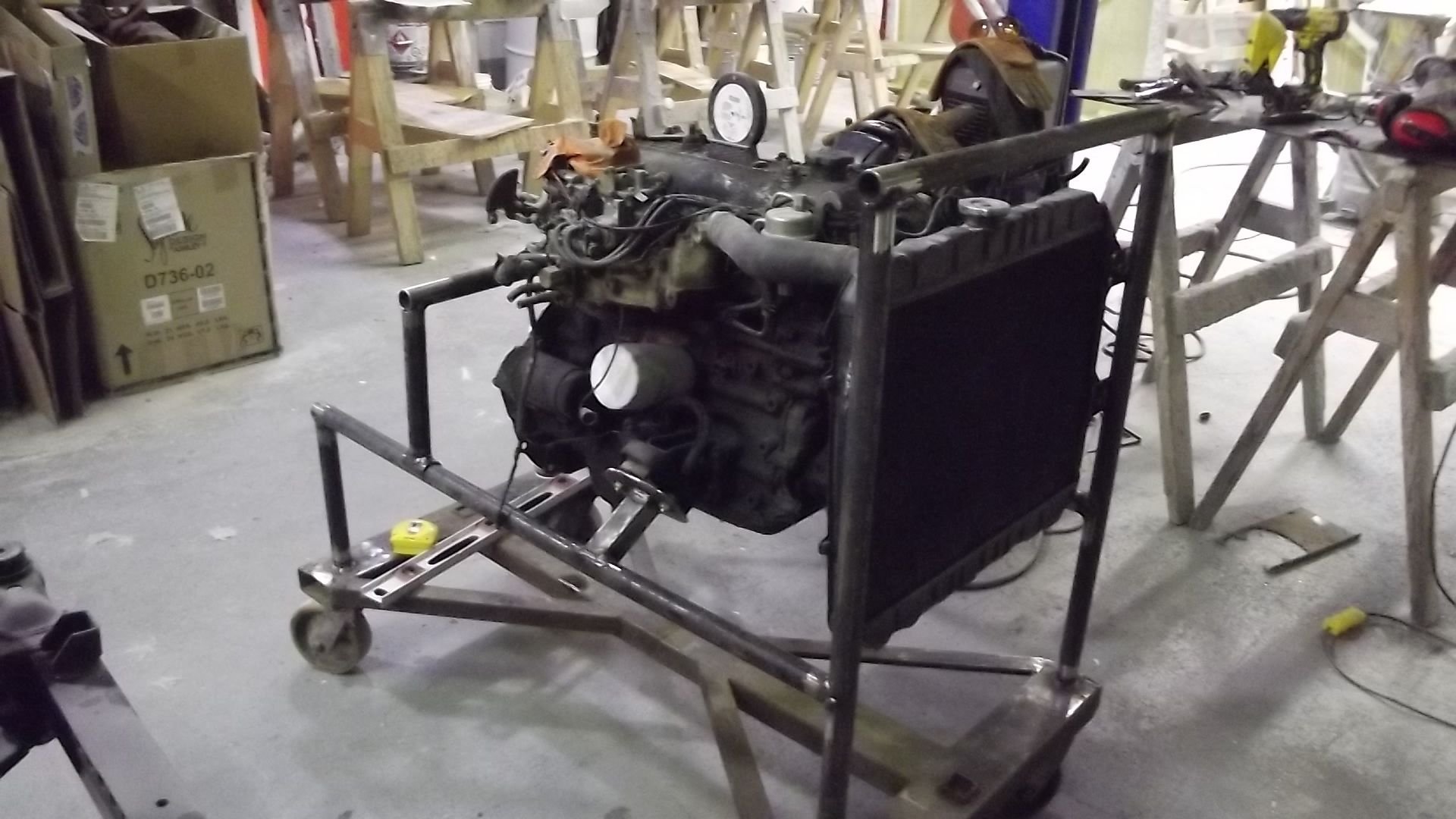

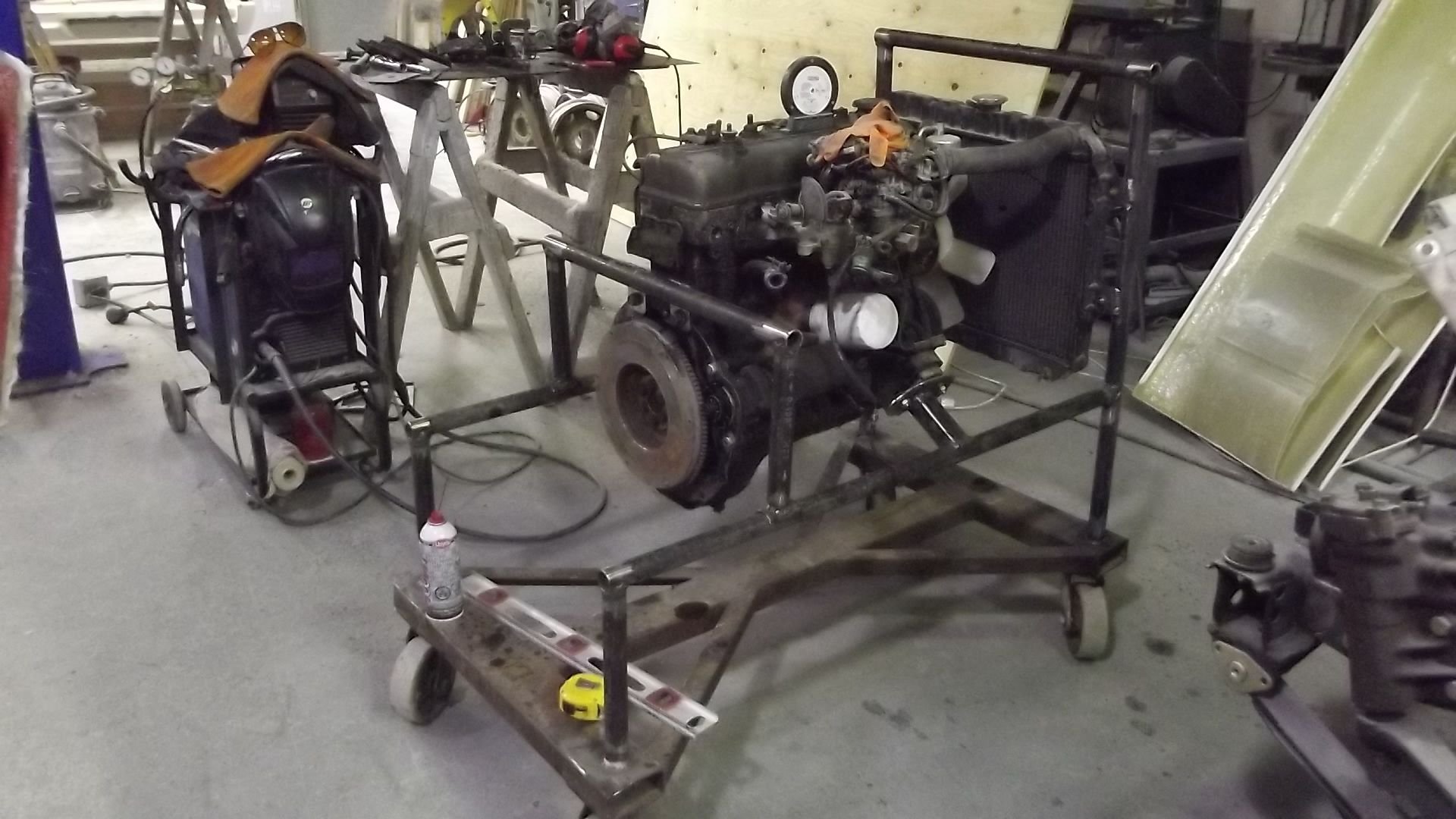

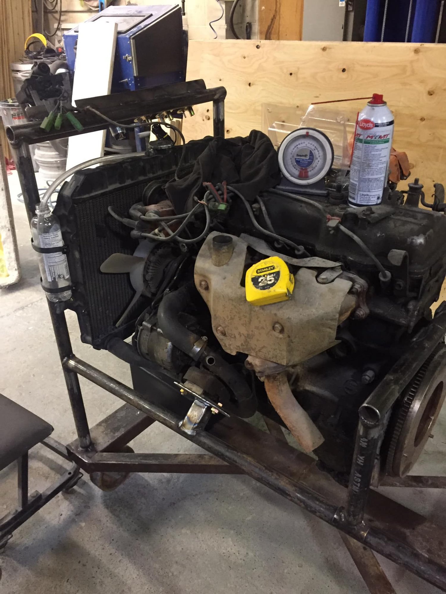

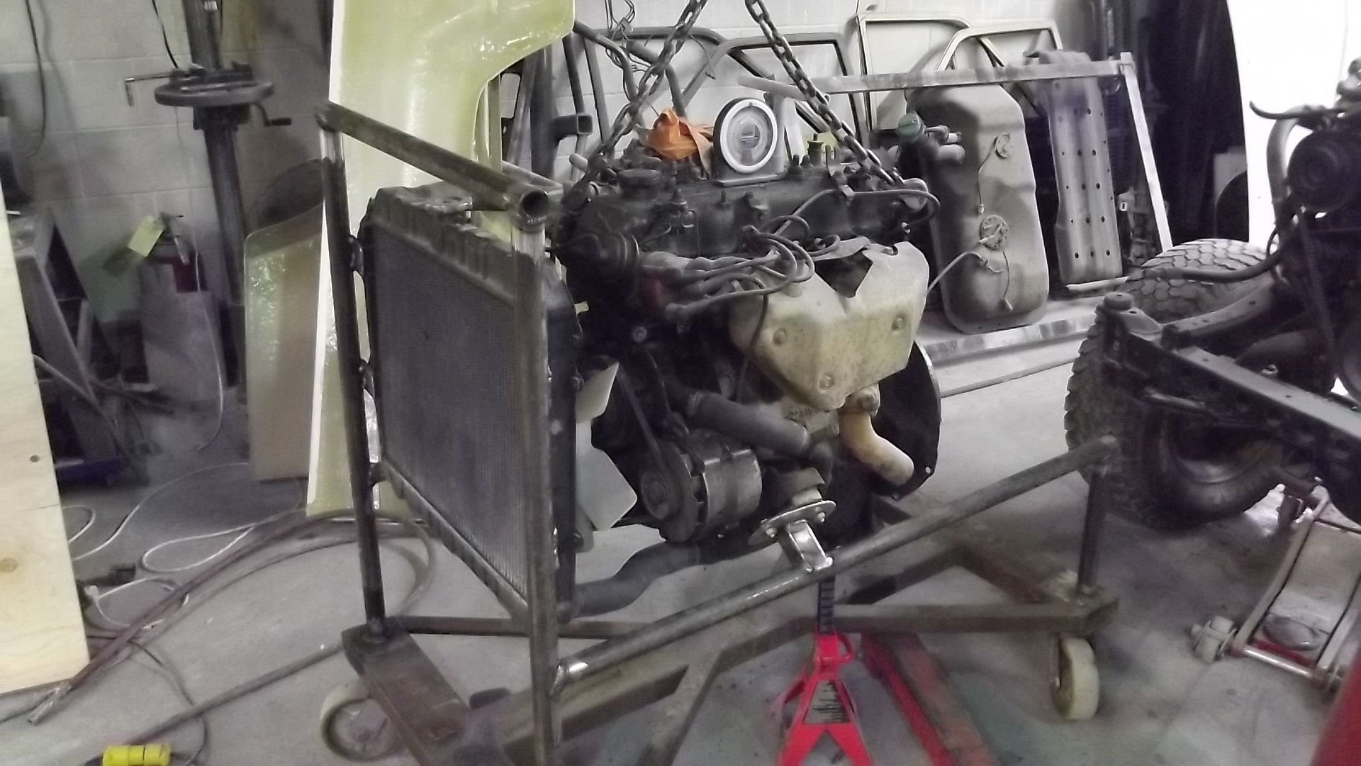

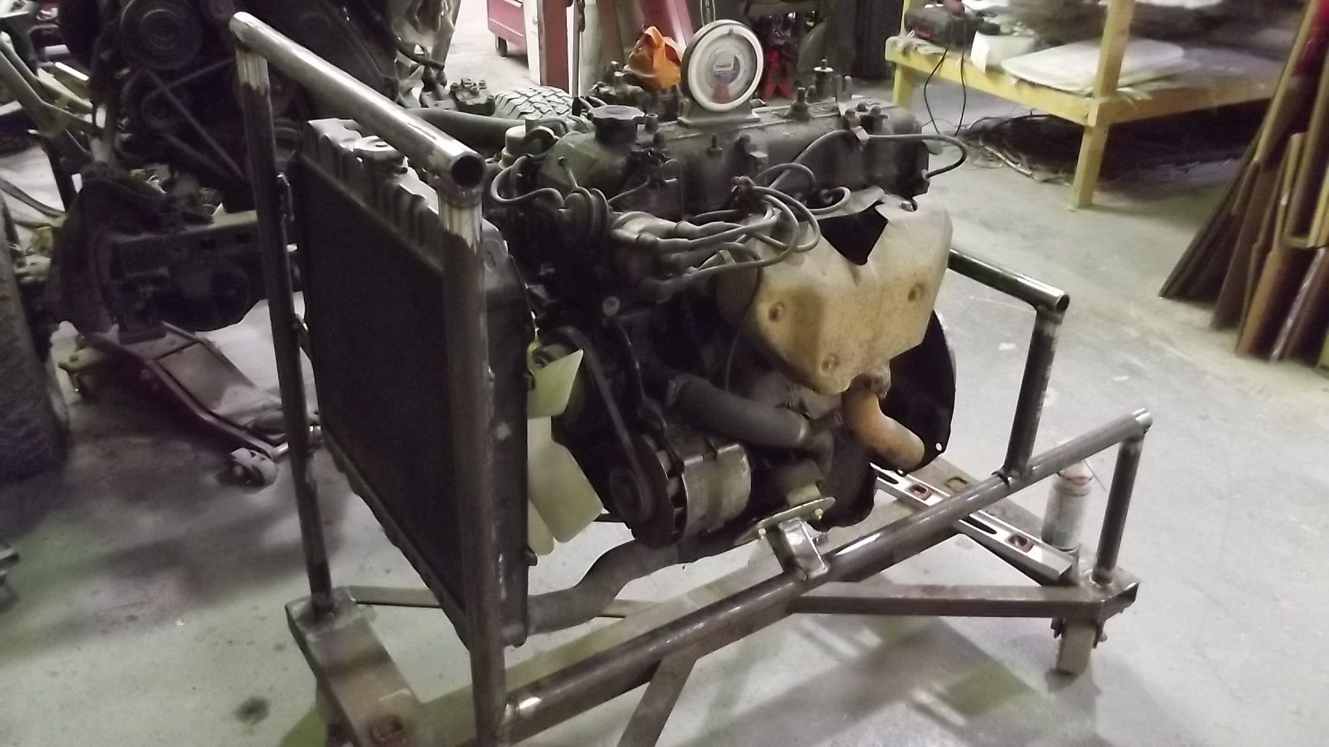

so with us building more and more engines in the shop , I decided I wanted a run stand (last engine had a faulty waterpump)
I'm tired of having to work on an engine that we have installed in a fresh engine bay , and then have to work on after !!
I have always wanted one , but really just didnt ever have time .. well I still have no time , but I'm doing it anyway !!
I'm almost done , Just have to wire it , add a fuel tank and done . I’m also going to build an “addable” transmission mount , with a booster , master and slave peddal set up
That I can easily slide into place to test our transmission builds , so far , I'm into it for $50.00 enjoy the pics .
