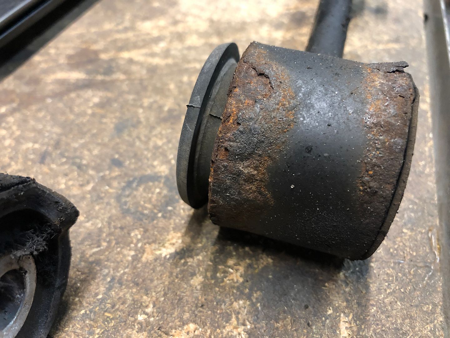

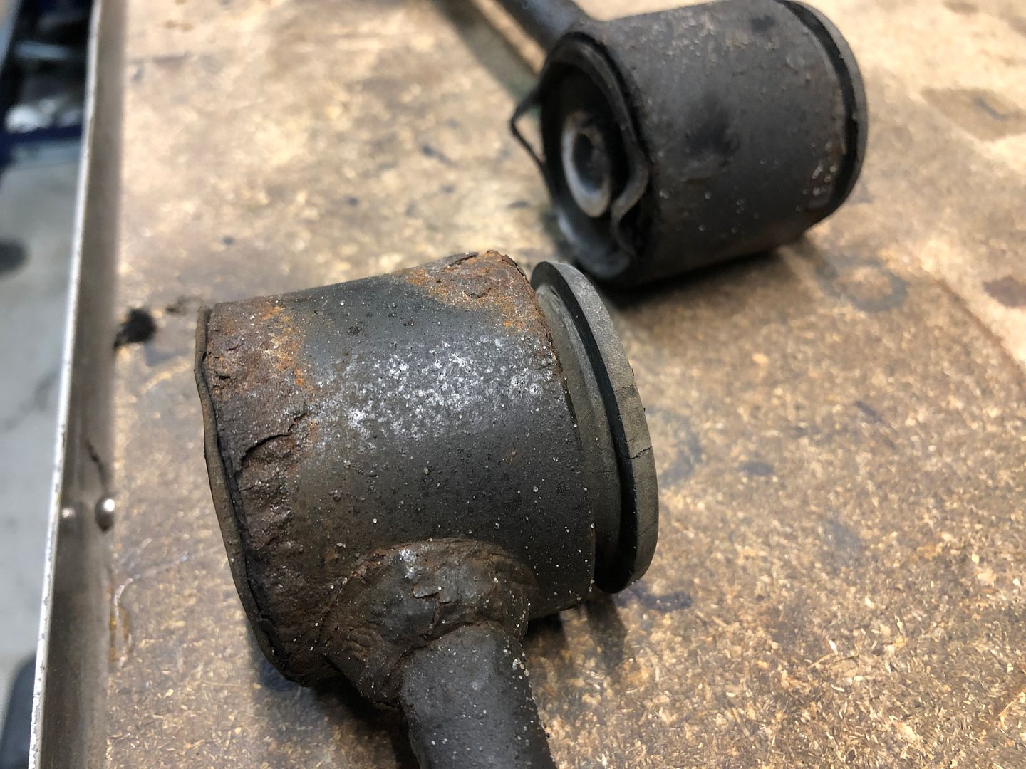

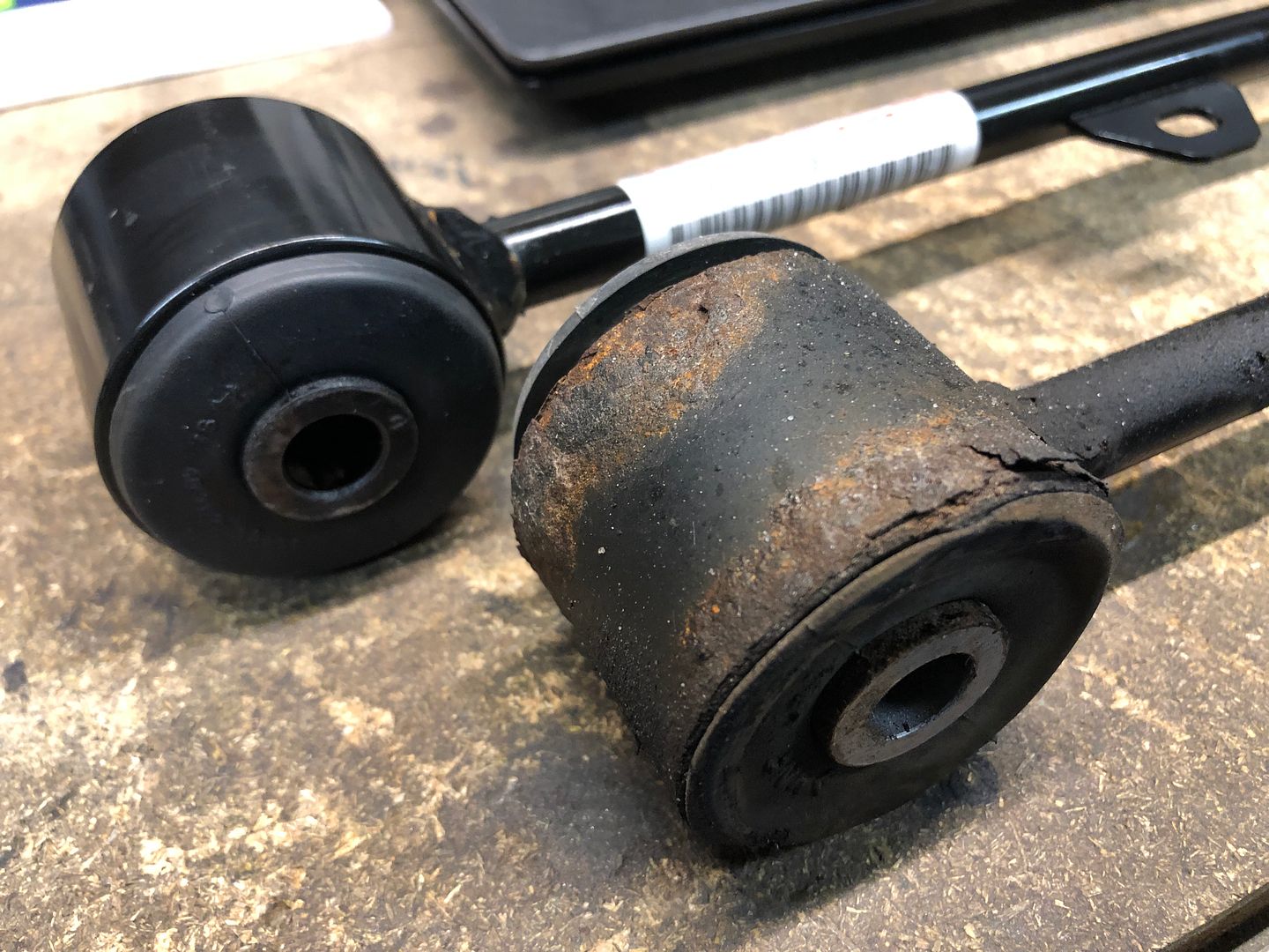

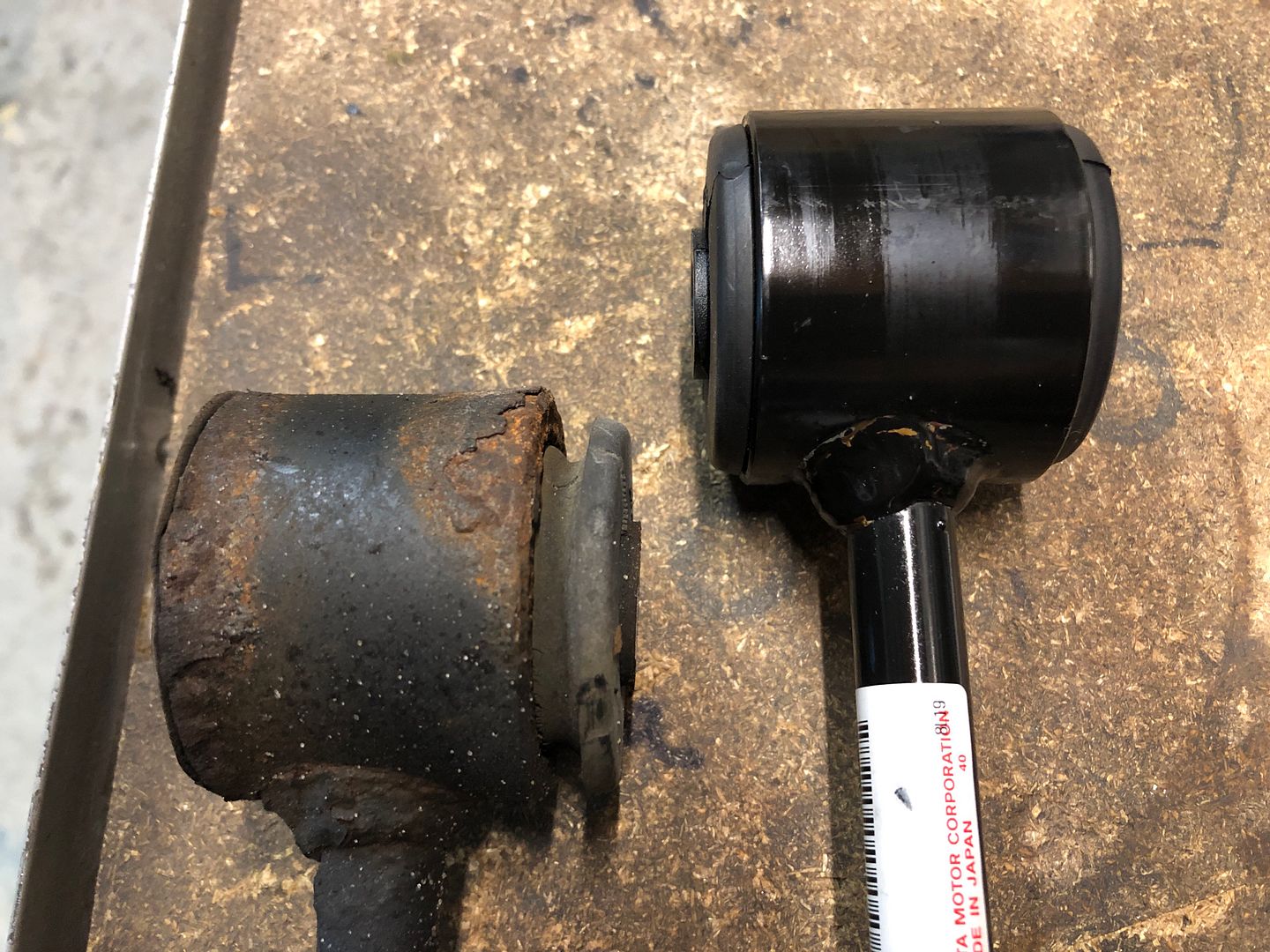

I’ve noticed more & more sloppiness in the rear end over the last year. A few years ago I installed new lower links to correct a ‘crabbing’ feeling under hard acceleration, and last year I replaced the original track bar bushings.

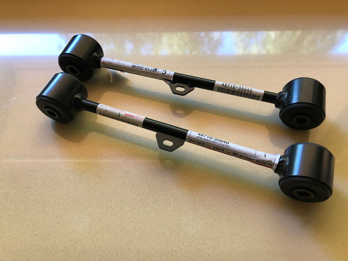

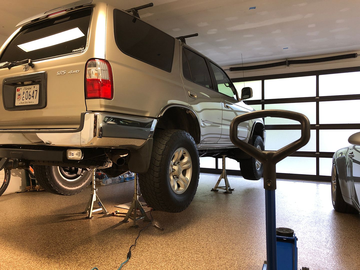

Yesterday I put the truck on stands and installed a new set of Toyota upper links. The entire job took an hour, start to finish, and it was pretty obvious that the 18-year-old, 435,000-mile bushings were beyond their intended lifespan.
